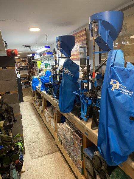

Hah! Ya can’t see it in the pix but there is actually some green on my bench. My workhorse press has been and will always be a RCBS rock crusher! I prep my brass a lot of times with the green then hit the Dillion progressives to crank it out. There is a whole plethora of folks that will challenge this process but it works for me. Plus I simply prefer the RCBS auto priming tool vs trying to seat primers in my progressives, yes they will do it but I like the ability to “feel” the primer seating in the brass. Plus sadly now we have to sort brass in same caliber by primer size. I would love to put the cost accountant that made that brilliant decision in the spotlight! Example 45 acp with both small and large primer size. Arghh…
I am with you on the Rock Crusher for initial prep, especially for my long range ammo that needs consistent headspace for max accuracy. I use a Frankford armory hand depriming tool and work in front of the TV in the evenings and do a few hundred at a time. I do a semi-auto process for most of my ammo. Deprime, clean, then lube and size in the Hornady progressive with case feeder. Then lube clean and manually prime with RCBS hand tool and back in the hopper to do the powder dump, bullet seat, and crimp it needed. All my LR ammo is loaded on the single stage and every charge hand weighed to 0.05gr. I might do some pistol cartridges all at once on the progressive, after that lot of brass has been processed manually/semi-auto first but I don't like seating primers in the press at all.

I am part of the Dillion group and you would think I am a heretic for not wanting to seat primers in my progressives. They wear me out!

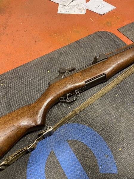

Speaking of period correct. I got my Garand put back together today. I got rained out so it beckoned to me! I may be a bit geeky, but when working on firearms I only do it when I want to, not when I have time. I have to be sure I am in the right frame of mind for very slow, meticulous work. If I am not in that gear I don’t mess with them. Anyway the Garand is done with original period correct sling. Again, huge shout out to the guys on this thread for both suggestions on refinishing material and also methodology advice. I sanded till my arm fell off with 600 grit! But man did she turn out great! I also added a pix of my go to reference on M1 and M14
