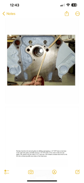

I pulled out the other book and looked through it. The only thing that I see that he says differently is to block the oil feed from the cam by clocking the cam bearings to block the feed holes.

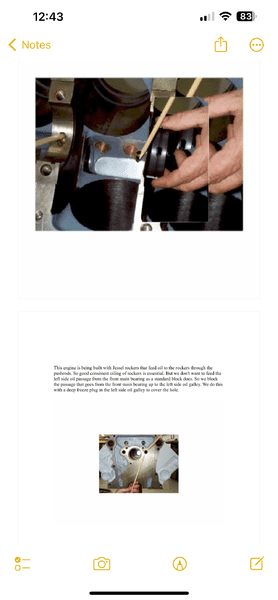

As for the mod to not feed any rockers off a main feed I did that in 2000 or so. Each shaft was fed from a separate feed that didn’t come off the main feed and it helped a ton.
The engine I’m getting ready to do won’t get all the modifications I did back then but I want to at least stop feeding the rockers off the main oil feed.
The block is already tubed on the passenger side and the oil to the drivers side is blocked with a set screw.

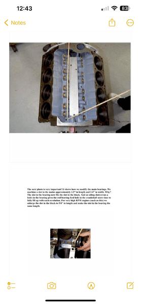

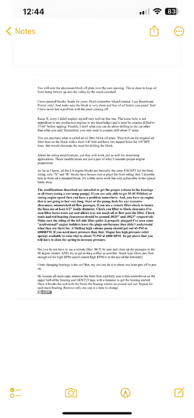

I went back and looked through my Sanborn notes. Two things I noticed. Yes indeed he used pushrod oiling. But he also had bushed lifter bores. So why run a crossover. You say it’s to feed the lifters. Sanborn says the crossover line was put in to reverse feed number 1 main bearing. I can repost his notes if you’d like. He says without that crossover, you are feeding all the drivers side
Lifters off #1 main leaving that bearing prone to failure. It is right in his notes.

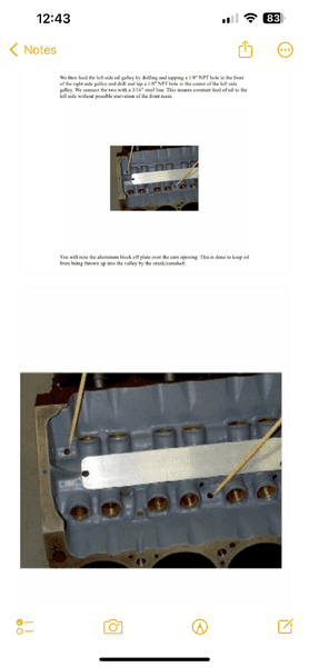

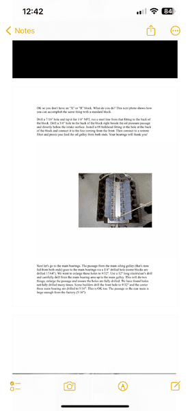

And I am telling you that his notes specifically say it is done to reverse feed #1
main.i am pretty sure that I posted all his notes in the original oiling thread on this topic. My point to you is his vouching the crossover works just like Chrysler has, but it is a two part modification. Sleeving the galley and plugging with a set screw was also approved by Chrysler because both mods cut some or all oil to the lifters.

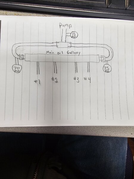

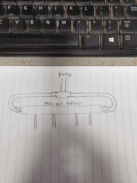

@Newbomb Turk . This is a continuation of post #54. In this diagram representing an oil circuit being fed from two opposing ends. Where in the main oil gallery would oil stop flowing?
I was going to post a drawing like that. It shows how ridiculous his understanding of hydraulics is. According to him, the oil will just sit in the galley going nowhere with 80psi pressure on both ends and not flow to the 4 leaks in the tube. He also denies that if you take away the front feed that there is no possibility of some of the oil running past those 4 leaks because there are 10 leaks at the end of the galley(lifters on the drivers side)
that are gushing oil and that number one main is the one that’s feeding 9 of those leaks.

I agree with some of what you say. But crossover does save bearings. How you say? You are restricting the oil to the number one main at the front of the block and feeding it from the oil passage at the rear of the passenger side to the front of the driver's side. This makes the number two main the front Main in the oiling on the passenger side. Therefore the oil is no longer having to make that 90° turn and then go on pass for the next Main bearing. Number two becomes the number one front feed. You are no longer going to take the chance of starving that bearing because the oil didn't want to make a 90° turn to feed it. So therefore the crossover tube does help save the number two and number four main bearings.
This is my humble opinion and I fully endorse it.
Remember I am talking hydraulic lifters here. If I was going solid I would tube the block and block the oil lifter Galley on the driver side.
BTW. your assumption that the pressure from each feed is the same. It's not. Also consider the FACT that somewhere in that pipe there are two different columns of oil meeting. That point can move back and forth in the pipe as the local pressure changes. Pressure and no flow. It happens.
Your assumption about what you think I assume is incorrect. I will repost #54 with my question.
"That is not my assumption. I didn't say pressure was equal through out the engine. I'm trying to figure out how having opposing feeds in the gallery stops flow at some point in the system. Can this only happen if the pressure is different at each end of the feed? or will this still occur if the feed pressure is the same on each end?"
You said you have a friend "who knows". Ask him which passage or passages from the main gallery 1-4 are going to receive no flow because the gallery is being fed from opposing ends. Maybe he can explain why this happens.
