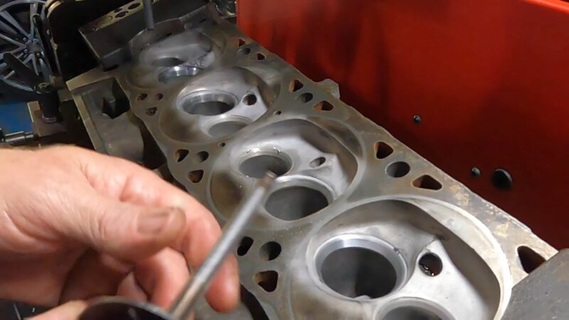

The guy worked a set of stock replacement magnum heads from Jegs to 259 CFM with a competition valve job only, before he started porting them !!
Worth a look
Worth a look
And this is how it begins ...misinformation...with somebody whose eyes do not know what they're looking at.
That head has chamber work all around the intake valve and has the guides mildly profiled in a subtle way that narrowed them up not made them round and aerodynamic... AKA if you only recognize porting as to look a certain way.. you wouldn't know what you were looking at. Nothing personal Brooks.. but if I don't slam the hammer...it goes on as fact when it is indeed a mistake.
They also backcut the valves. I don't backcut. I've seen a tendency of reversion on Street stuff with big cams and when I stopped doing it that went away

But the problem is you posted, almost exalted, the amount of work done and the amount of cfm obtained as if magical and EZ without disclaimer. A disclaimer afterwards is good but seen as an afterthought and possibly covering up.
I didn’t watch the video, but are they actually an OEM head?

You'd do better if you presented it that way. You kinda misrepresented it lol..and it doesn't read like a question. Glad you're researching and learning. You just learned those castings need x amount of work to be good. Now thats two accounts of the same requirements. That's soild useable information that you have and can apply yourself and make more power.
I too have seen that video sometime ago and complimented the work...as I know that took a min to do on that head.
