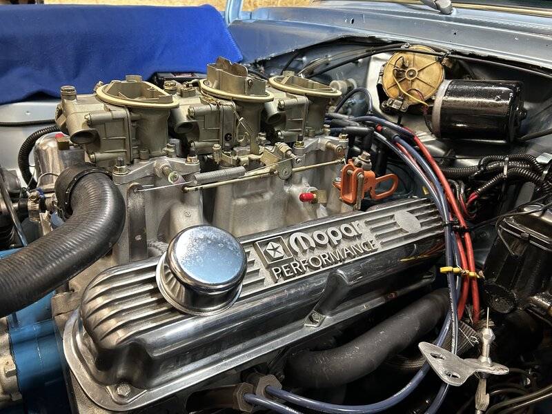

I’ve decided to use the Indy heads, the Trick Flows would allow me to use a six pack setup I have or the tunnel ram easily.
I can mod the tunnel ram for the Indy heads fairly easy but don’t really want to do it for the six pack.
The more I think of the work I put into the spare hood, I am sticking with the tunnel ram.

You could probably sell the Sixpack setup, and finance the trick flows, with a buck or two left over......
But if I HAVE the indy's, and I have to buy less-flowing heads?....... I'm running the indy heads, 100%
Yep, that’s the route I’m thinking about going.
It’s hard to beat the tunnel ram for several reasons and I have the Indy heads already.

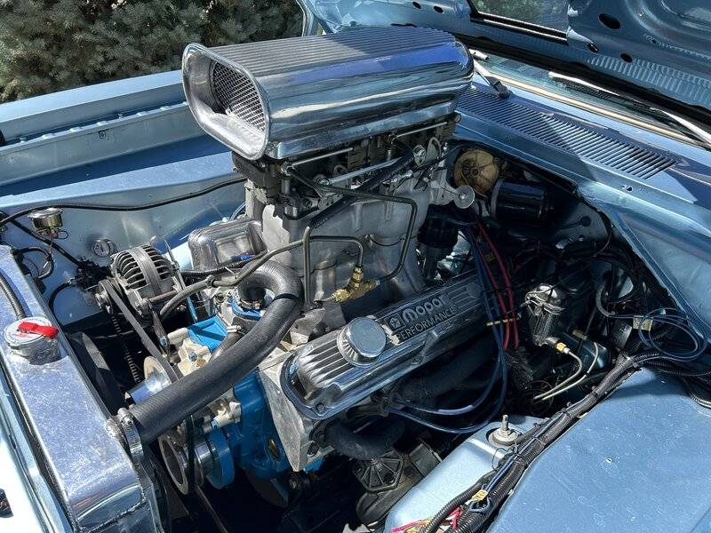

I just got the results of this build and I am smiling.
I stuck with the Indy heads and went with Holley 550 tunnel ram carbs custom built from Allstate Carburetor.
Molnar 416 stroker kit (418) from @PROSTOCKTOM.
My builder didn’t beat on the engine, just ran it for break in. Nice weather for the dyno.
Looking forward to getting in the car.

I only have some of the numbers so far. I’m at 5000’ and wanted to keep cyl pressure up so the duration is lower. It’s a solid roller for the street so I wanted it to not be tough on the valve train.
The builder’s cam grinder picked the specs from the info I gave him.
It is a smaller cam but I’m not looking for max power.
I’ll post the specs once I get them all.
I was hoping for 550-600 and am happy with these numbers.

He built a stock stroke 340 for me a few years ago. It has Edelbrock closed chamber heads, with a Holley 650 on an airgap intake. It made 400 Hp / 408 TQ.
It runs great with a tunnel ram, or six pack.
When I came across the Indy heads, I just had to have him build something a little more.
This new one should be fun. I found a new Chris Andrews 904 with custom converter, rmvb and low gear set to replace the 727.
It seems to be in the range of the trickflow 190 head builds That's a good build.
Tunnel ram is awesome & a Chris Andrews transmission.... Hell that's good stuff
