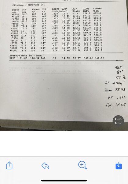

Yes, the Indy heads are on it. Took some thinking about which way to go. Some said Trick Flow and some said Indy.
It was on the dyno yesterday and I’m happy with the results.
Looking forward to running it in the car.

So, what's the combo, and the power curve?
I don’t have all of the cam specs yet.
It’s a 1970 340 .040 over with a Molnar 4” stroker rotating assembly 418. 11.5CR +/- Solid roller cam, roller rockers. Of course the Indy heads with the Edelbrock tunnel ram and Holley 550 carbs.
So far all I have is this dyno sheet from yesterday. My builder is out of state and I should have everything else soon.
The cam is a custom grind for 5000’ and the rest of the combo.
