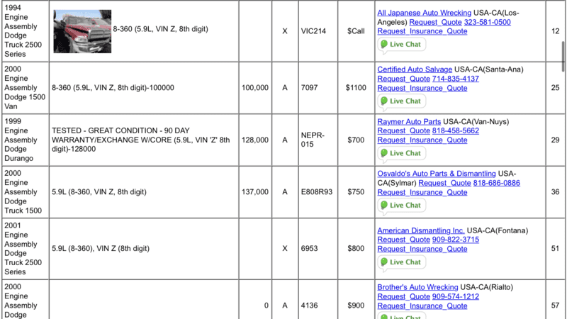

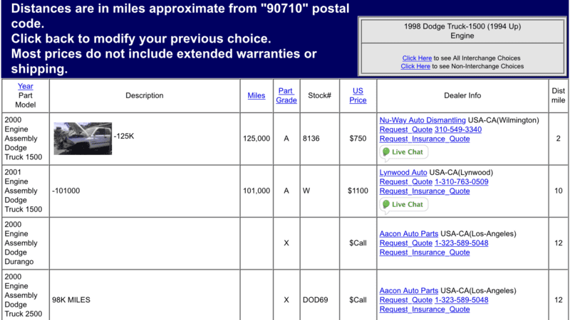

If you want to stick with a small block, I would recommend a 360/5.9. There are tons of them on craigslist and at pick-n-pull places, still attached to the trans.
Pick-n-Pull

318 360 magnums are at are Pick-n-Pull for less than $200 with a 6-month warranty...
