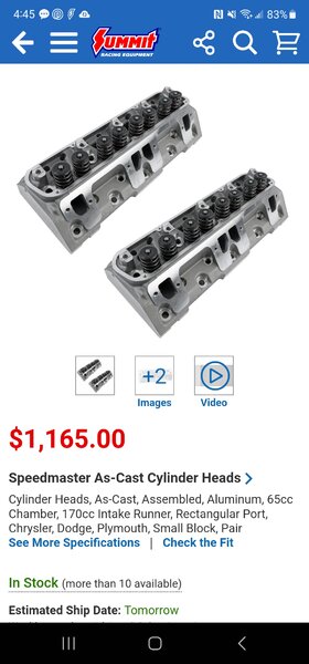

With the replacement pistons did you measure how far down in the hole (deck height), are they flat tops? The speedmaster heads, did the say how many cc the chambers are, aluminum or iron? just trying to guess on comp ratio.

If my memory serves me right the were .110 in the hole. And these are the speedmaster aluminum heads.

That cam want's minimum 9 to 1 your closer to 8 to 1, your choice more converter or smaller cam. you said base timing at 20 you didn't say anything about centrifugal specs?
