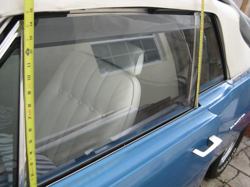

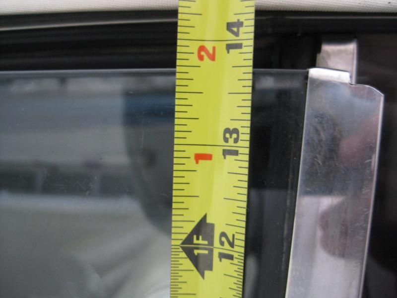

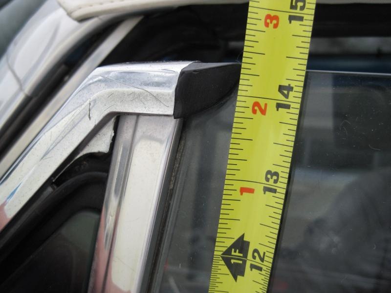

VDart- sorry took so long... but heres a couple pics of glass measurements from from door to roof for my 69 Dart convertible. Looks approx 14 3/8" slanting down to 13 3/4".
Never took it out so do not know exact measurement of glass piece top to bottom.

thanks for the pictures--
I just went out and measured the door glass--
convert glass is approx 16 11/16" tall at the rear while hard top glass is 17" tall at the rear.
