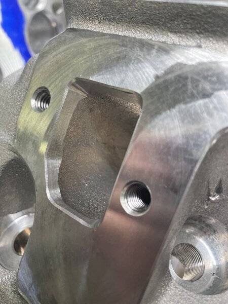

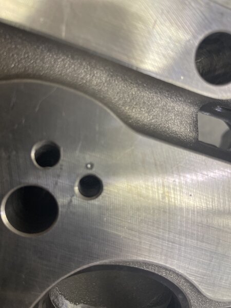

Is that something new with the exhaust ports? I don't recall seeing them machined.
No if you blow it up you will see it’s kind of an ugly plunge cut that they do. If you need a better picture I can post one, tomorrow. It’s blooming hot in there. Lol
I see it now. What do you suppose is the purpose for that plunge cut?

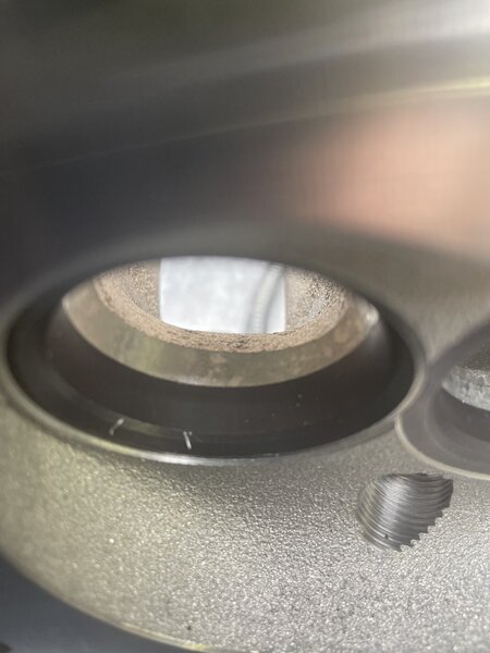

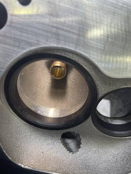

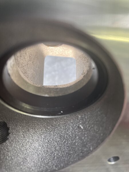

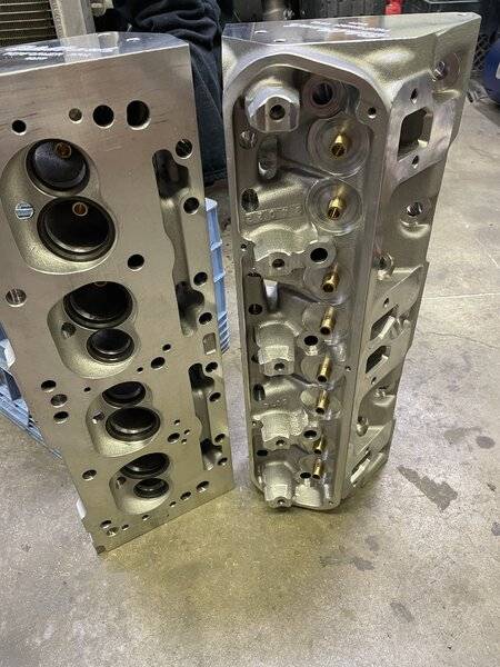

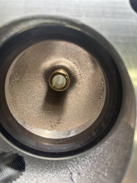

Ok here we go as promised. Exhaust side first. I’m going to let you guys comment first. Try to address your comment exhaust side intake side. Here we go.
Looks like a virgin set of heads to me , ripe for a burr.
seats sunk a little? lot of looks like scratches in the deck surface. ruff "looking" casting in the ports.
lot of spark plug thread in the chamber, where does the plug end up?
I’m not ignoring anyone but I want to hear what you guys think. Then I’ll chime in.
Almost looks like someone started on the ports and then returned them.
I think I like the looks of the Speedmasters.
After you perform your magic John, they will be an amazing set of heads.
Can’t wait to see the results.
