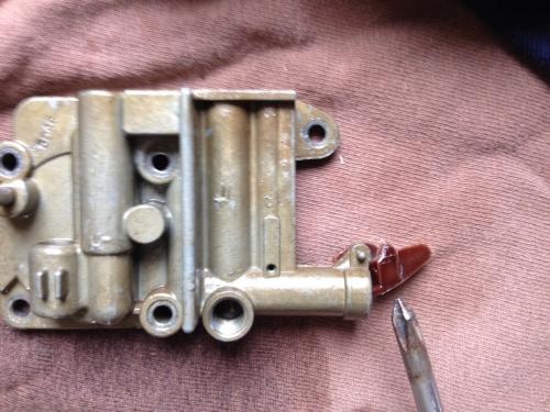

I took it apart again and found I did not have a pump return spring and on top of that broke the little dark red plastic piece in the picture. Now looking for parts or a complete working carb while I'm checking the valve lash.

You'll probably have to find another carb to get that piece: I think it is a later model metering block. Or, fix the lever with epoxy if you can. You can get a complete rebuild from Mike's Carburator in WA state for $159; 'd trust that more than a parts store unit.

i made one out of steel once. and the lever on the outside, not easy but it CAN be done. OR find some one with one of the new 3 D printers.

That lever is part of the "economizer". Similar to a "power valve" in 4 bbl carbs, it opens ball ports to richen the mixture at high manifold pressure (high throttle). My 69 slant idled like that for decades, thru many 1920's. I finally got a good 1920 and it ran unbelievably smooth. The metering block tends to clog internally. One guy here knows how to blow air pressure thru to unclog them.
