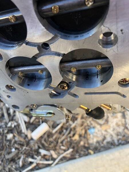

3) that the transfer slot exposure under the throttles is about square
4) that the mixture screws are set to about 3/4 turn out from lightly seated

1) In Park; rev up the engine to in the range of 1800 to 2000rpm or thereabouts and put the throttle on the nearest fast-idle step; exact rpm not important. Next; close the mixture screws lightly, and make sure the rpm goes down. Then open the mixture screws until the rpm peaks or the adjustment is more than 1.5 turns with the rpm still rising; this should not happen.
2) If it does, then the transfers are lean. The rpm should peak with the screws at from 1/2 to 1.0turns out from lightly seated. Put the screws back to 3/4 turn and kick the throttle back to idle, and let her cool off.
3) if the transfers are too lean, we have to figure out why, and fix that.
4) if the mixture screws behave normally, then you do not have a vacuum leak and we can continue.

1) lets look at opening the throttle. The first few degrees are handled by the transfers. If you have a tip-in hesitation, which is; a moment in time that the rpm hangs, falters, or decreases, during SLOW opening of the throttle, we have to fix this. With the mixture screws properly set, likely the transfers are ever so slightly too far closed. Remember, this event occurs before the accelerator pump can respond, and it happens with a slow opening of the throttle. You have to fix this before moving on; because the pump can never eliminate this and when it happens, it is extremely annoying.

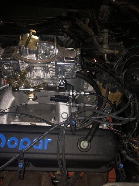

2) after that is fixed; make sure your accelerator pump squirts fuel the very instant that you open the throttle blades more than just a few degrees. Sometimes you have to bend the link-rod, or eliminate slack in the system, or change tuning parts.
