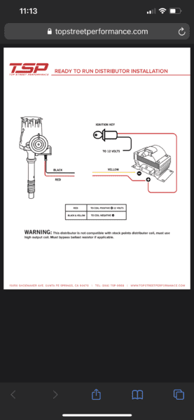

After a separate post, I know I need to combine start and run power into a single wire for my ignition coil. I upgraded from points to an internal module HEI distributor.
I am trying to figure out which wires to combine. I will post a couple photos, if anyone can confirm... i feel like the brown with the eyelet is a run 12v and I just need to figure out what to combine to bypass the resistor.

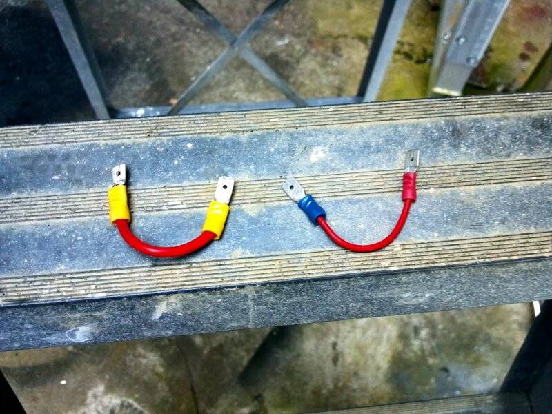

you can just unplug them at the resistor and use a jumper wire to connect them.

A plug in jumper will work

To keep the somewhat stock appearance on mine (and to revert back if I ever need to) I took an old ballast resistor and removed the resistor. Then I took some 14 gauge solid from some romex and soldered that to the connectors in the ballast. Looks like it's still there and looks better than a jumper.
