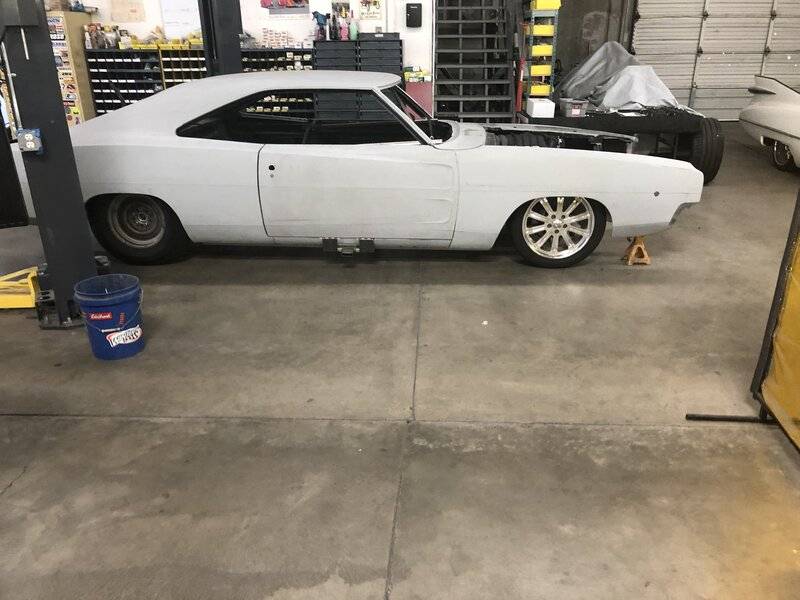

Set the Charger at ride height last week, sheet metal work begins this week.
looking good!. You must have the front wheels really tucked in or are the front wheel openings gonna get a little massaging for lock to lock turning?
The wheels on the car are just rollers, but you’re right about turning radius.
I like what the mid-70's Pro Stock builders did. They stretched the front wheel opening to the front by moving the front of the wheel opening forward and adding plus / minus 4" in the middle. Then they moved the front axle centerline forward 2". That allowed for not only a good size tire, but additional clearance right where the tires want to hit that curved fender lip. Added bonus of moving the centerline forward..... more room for the rack.
Too late in the game I think for me to be changing the wheelbase but who knows.

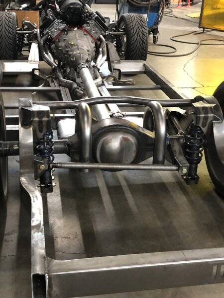

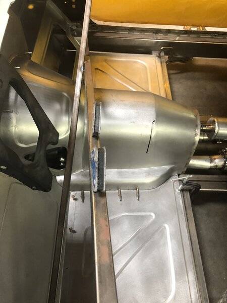

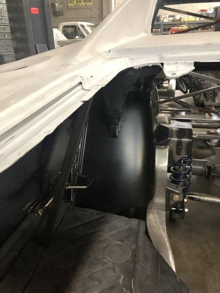

More progress on the Charger, headers are done, firewall has been roughed in and the rear wheel tubs are in.

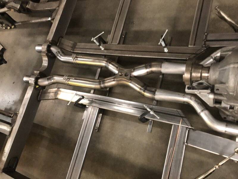

Here’s a couple header pictures. The right header is being fabbed, the left has the high bend and is complete.
That’s the steering shaft under the left header pipe.
remember what the Late, Great Mr. Hoover said...."Everyone should have to build one set of headers, but no one should have to build more than one".
Are you doing the header fabrication?

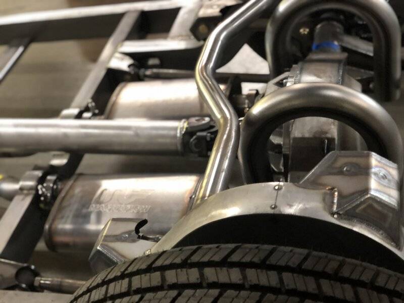

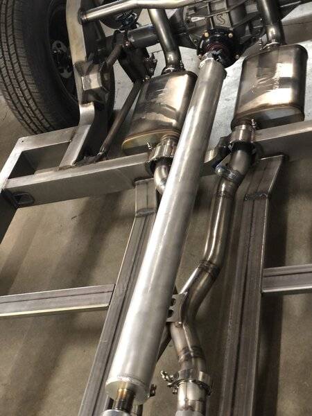

The exhaust is about done, mufflers will go behind the rear end.
nice work....looks like they can slip up and out if / when needed too. Thanks again for keeping us up to date with the great play-by-play of your build.

More progress. The drive shaft was installed this week and the exhaust has been run back beyond the rear end. Going to do the gas tank next then finish the exhaust.

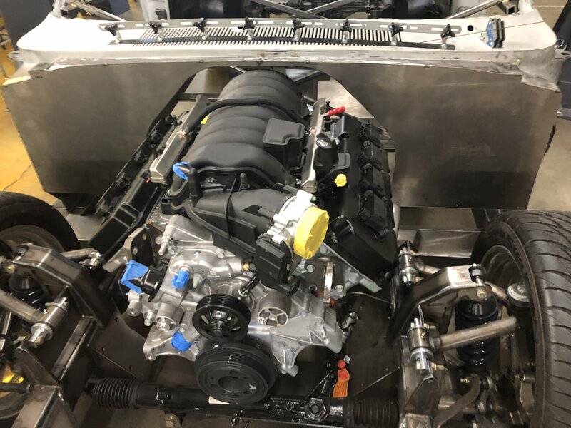

To accommodate the transmission, the entire floor pan and firewall came out. With the full perimeter frame the engine was moved back 5 inches and dropped 2 inches to clear the hood. I'll post pictures next week.
