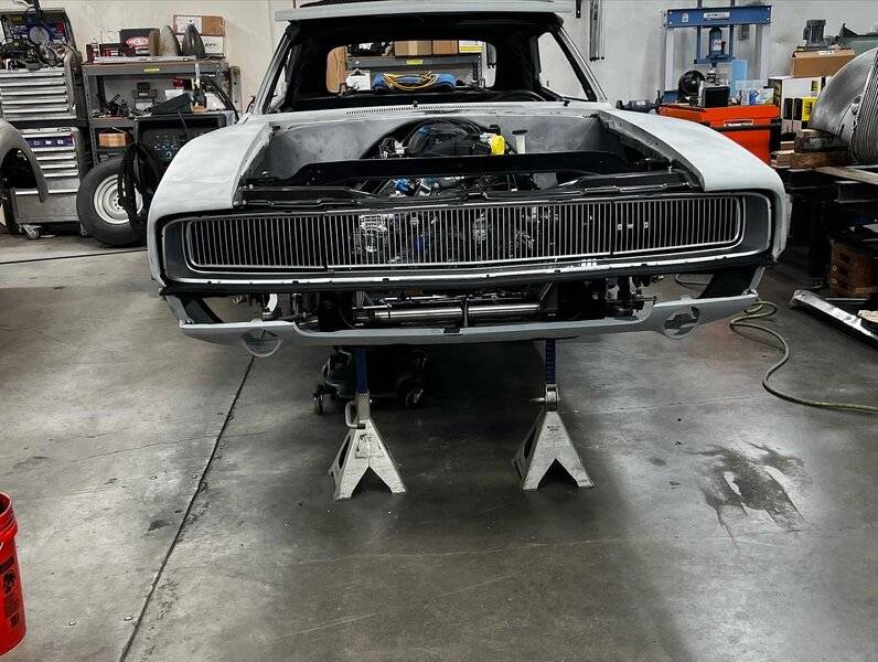

This build is just so amazing to me. After spending four years stuffing a Gen 3 in my 72 Demon. I am just amazed at the skill and creativity of your builders. I look at threads like this and realize while I am a fair welder I am just not a car builder! This car is art in its purest form. I have fabricated two pairs of headers in my life which I feel was two to many! And the only reason I was remotely successful building my Demon was 100 calls to Denny and one of his HDK front ends. Otherwise mine would still be on the rack! Just a stunning build guy and a 68 to boot! I love the round tai lights!

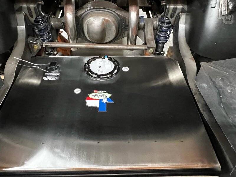

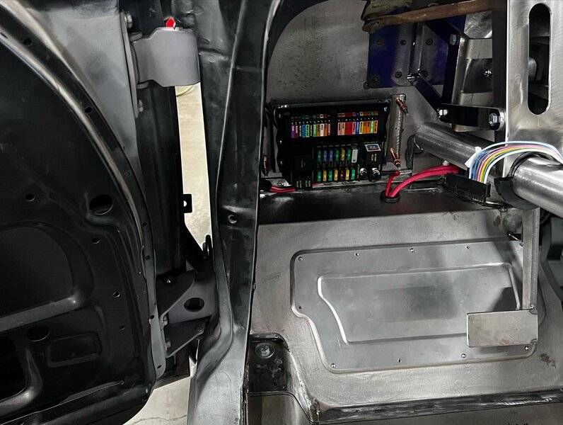

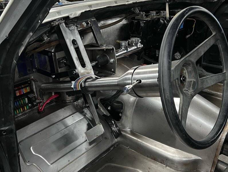

Here are the latest fab pictures of the interior. The gas tank, steering column, master cylinder, brake pedal, gas pedal, A/C , and multiple fuse panels are in. I still need to mount the brake electric vacuum motor assembly (a la Prius).

Here ya go Denny, I am sitting out in shop self medicating in my chair with my custom sliding stainless shelf and just spun around and took this pix. Your front end can just be seen past the Cherry Bomb glass packs and long tube headers behind the Hemi nestled in your frame. Couldn’t have done it without ya guy! Heal up! Please note I have been shoveling snow like a dog thus the “Gatorade “ (adult version)

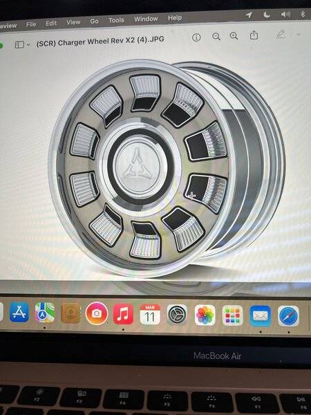

I've been absent for a while. Here are the renderings of the Charger, the wheels, the interior, etc. The wheels should arrive next week. A lot of the interior structure is going to be 3D printed.

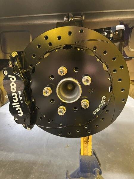

Slowly but surely its moving along. Check out the brakes! Front rotors are the size of dinner plates. The little caliper on the rear brake assy is an ebrake.

Who's fuse panel and wiring harness are you using?
I think I saw that Wilwood e-brake @ Carlisle this year....I believe it is electric on / off. I will use it on my current build.
Electric on off?
Kinda slick, but it means parking duties only. No way to modulate it for emergency braking…
Electric on off?
yes....very similar to the parking brake on a Ram pick-up.
the good part....no e- brake brake cables, just a wire.
