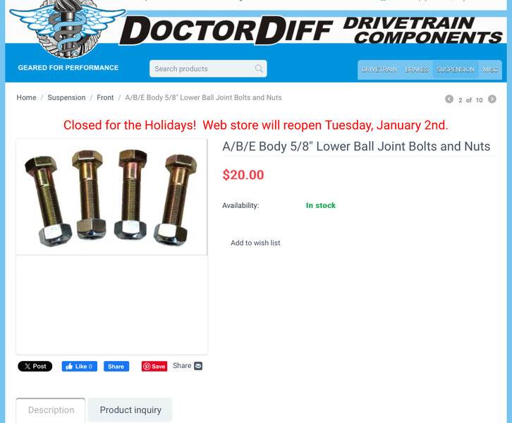

That's because you didn't read the entire description- it says:
NOT "All A bodies no matter what year".
I have 5x4.5” brakes
your kit was supplied with some generic bolts, that's why they're too long.
these are the ones you need.
unless your LBJ is still 1/2" in which case you'll need to replace them or drill them out and use these bolts or OEM bolts. OR modify the bolts you currently have OR source shorter 1/2" bolts
