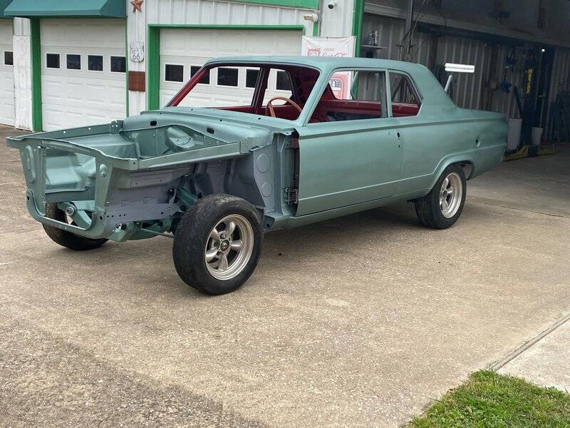

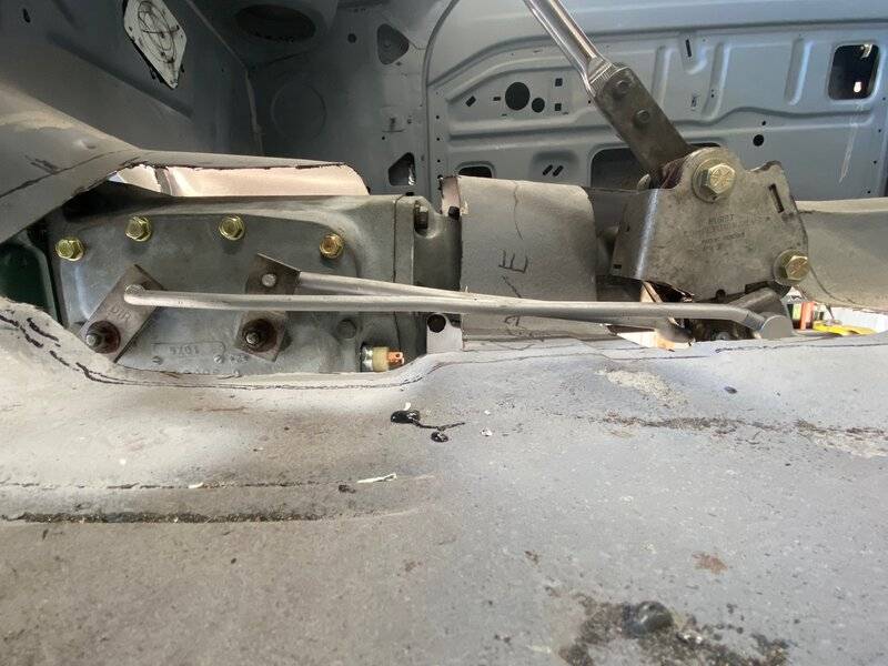

I'm thinking I want to go ahead an install my Super Six into my '63 Dart, I just need a hydraulic clutch, well and pressure plate/clutch plate.
I know about Brewers, just looking at other options. I even wrote Red Roberts at Driveline performance as I helped them design the clutch system adapter for a 67 Mustang with a power booster, still waiting to hear back.

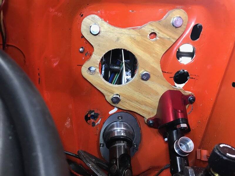

My 67 Mustang with hydraulic clutch
I made this piece of plywood and sent it to Red Roberts at Driveline components, then they made it out of metal and sent it back to me for test fitting;)

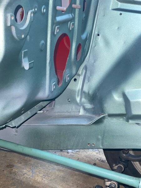

I just don't see how it all works! or where's there's room on the engine firewall side for linkages. or where the ball thing will mount onto the frame? questions questions
