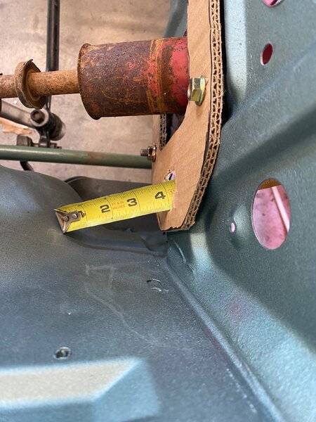

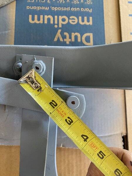

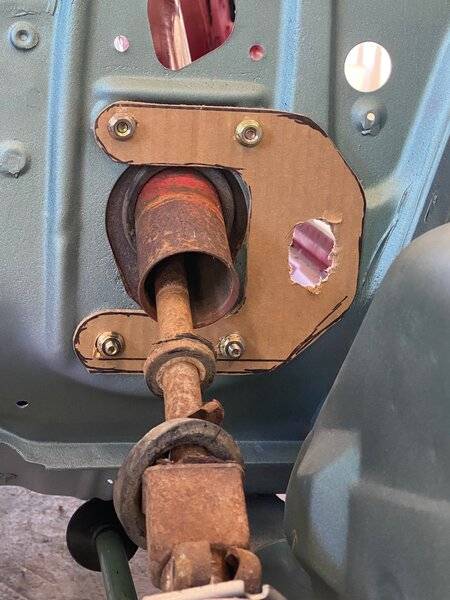

This is some pics I sent to him with measurments, I told him it be useless unless he can come up with a shorter clutch MC.
He would use 5/16 plate, last time he used my template and now is on ebay;)

Red Roberts idea was for little to no drilling~ he wants an item to be installed as simply as possible. Sometimes it just doesn't work out that way.
This one, one just makes a hole, mounts the mc and there you have it!
