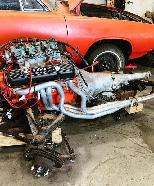

Engine's out, but I'm starting a 48 hour shift today. Won't be able to get to it until Tuesday. I'm going to get a converter ordered preemptively but I'll post pics of the snout ASAP.
Converter arrived yesterday....next day delivery from Summit! Anyway, rebuilding the front end today and will post pics of the old converter/pump/bushing soon.
I did notice something peculiar on the headers though. The headers are newish and polished, but #6 and 7 both look dull, like they got REAL hot. I'm going to pull all the plugs and have a look. I have a thread going on about a misfire I can't fix, but I'll ask here as well: what could make just two cylinders run so much hotter than the rest?
I'm no expert here, but my 2 cts. would be, maybe in time they will all look the same, being new. The other thought is, maybe those two exhaust valves are opening to soon or not closing all the way. You should here a popping sound. Check compression on those two cylinders.
I sure hope they don’t all end up dull like that, I paid extra for polished. And I will say that the last time I pulled the plugs, #6 and 7 were badly carbon fouled.

Pull all the plugs and check them also. All carbon fouled ? too rich fuel, wrong heat range or just the two, change out the two wires, maybe they are old and shorted out. Look at the wires in the dark (motor running) and look for an arcing. Uncross wires.
I could be wrong but it looks like the power brake line goes to #8? I do lose fluid, but I've always attributed that to my leaky proportioning valve. I pulled the plugs and they are all rich. I do remember richening the mixture when trying to see if that would solve what I thought was a lean condition. Didn't work.
Here's the #6 header, you can see how it's dull and some of the finish became powdery.

Pulled the plugs yesterday and they're all rich. My wires are new and I've confirmed continuity, plugs are heat range 5. I will say that I richened the idle a bit because I suspected a lean condition, so that may be the cause of the rich plugs. I'll do a compression test once the engine is back in.
Are you sure you have the right plugs? They look like GM plugs, short threads.
Hmm, since you're asking that question....no I'm not sure. Should my plugs have longer threads?
