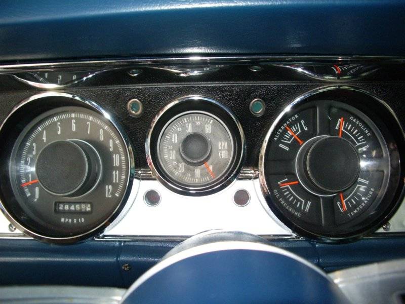

In dash cluster aftermarket tach replacement-69 Cuda rallye cluster

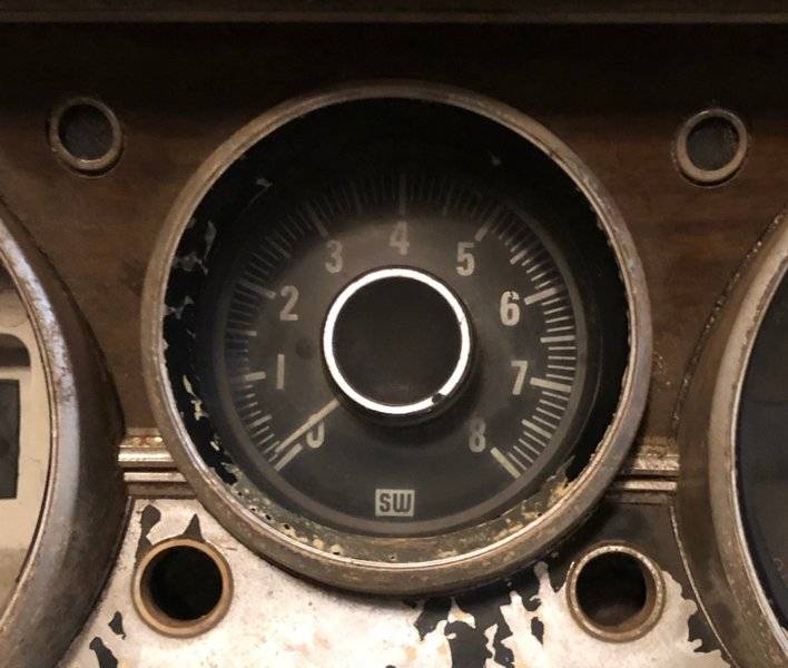

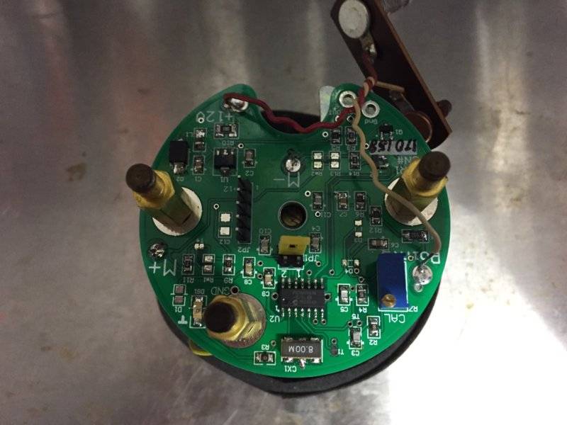

The pictures Mat posted are mine, I bought an SW 3 3/8” tach and pulled it apart. I cut the housing it came in down and fit it into the stock gauge cluster. I then used the block off plate out of the original cluster and cut it down to make a mounting ring. In retrospect, I would just make up some little 90 degree mounting tabs. Cutting the ring down and sanding it and fitting it was unnecessarily time consuming.

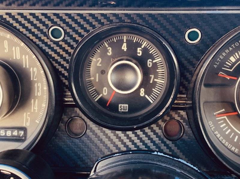

Anyway, I fit the 3 3/8” tach into the stock rally gauge cluster without modifying the stock gauge cluster at all. All the mods were to the aftermarket tach, which was like $150. So far it works great! It looks a lot better in my car than it did in that spare bezel I had laying around for the picture, that was just an extra I used to do the fitting.
I liked your idea of the 90° brackets however with a gap between the new gage and the housing i just see a lot of dust making its way inside the cluster. For you out on the west coast may not be too much of a problem. But its dusty as heck out here in west Texas. Heck i had my truck locked up with windows all the way up 6 months under the carport, and the dash ended up with a fine coating of red dust on it. Will probably make mine like your original one using the original blank off plate, or make a new plate with hole in the middle for the tach out of some .100" thick aluminum sheet i have.

Here’s a picture of the finished product with the SW tach in my car...
