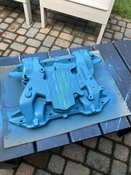

Painted the intake. I think the body shop did a great job of matching the paint!
Remember the color will change some after a few hours at running temp...
