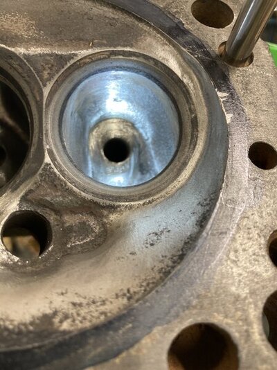

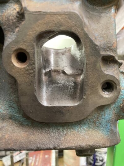

still plugging away, the chambers are done, hand deshroud, intake guides milled down about .200, exhaust about .030. Exhaust bowl blended, still need to work around the guide boss and profile the roof hump. How much can I knock down the hump?? I’m thinking only around .010 to .020 after knocking out the old core plugs and taking a peek.
Got rid of the guide tail. Still a little work to do narrowing down the guide.
Nice work and well worth doing!
A little fat on the backside of the guide maybe?

Well I think this is about done!! I’m running a 6 pack intake so if I can get these to go near 240cfm at 500/550 lift with a 2.02 valve I’ll be happy. Now to start the other 7 cyl.
Nice looking work. I have a 360 head that is all cut up if there are any particular sections you would like to see in pictures.
Which casting is it? I need to widen the short turn on my junk but I know they get real thin in that area. Learned that one the hard way.
FWIW……..you don’t really need to do any of that “boat-tailing” behind the guide to reach 240cfm.
After you have the seats cut for the 2.02 valve……you’re going to have a bunch of blending to do.
Yes. I’m going to shot for about 89% of the seat width.
