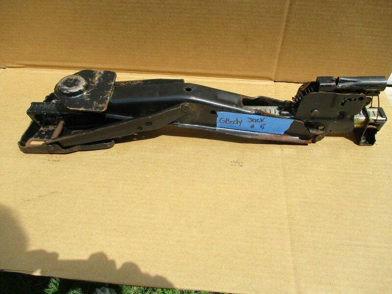

I once helped a lady change a flat in a store parking lot using the jack in her Pontiac. I thought, "This is a pretty neat jack design". I got one from a parts yard and tied it onto my OEM jack with a bungie cord. After 14 years I've never needed to use it. 1978-88 A-G BODY SCISSOR JACK OEM GM T TYPE Car Jack Buick Chevrolet Pontiac | eBay
