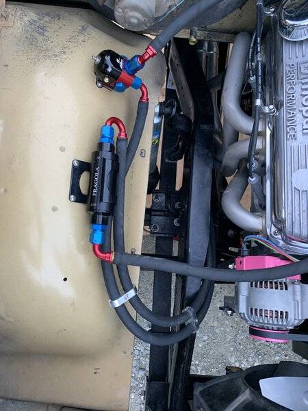

I’ve been real sick since Christmas, so I’m feeling better finally. It’s been real cold outside, I don’t like seeing the condensation on my engine so Today I was under the truck and finished most of the fuel lines. I had to do something to make some headway. I’ll continue up to the carb, filter and regulator once I get the front clip back on.

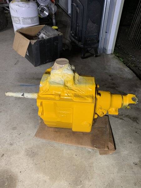

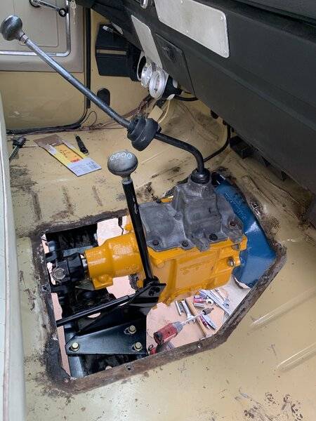

Tomorrow I’ll bolt on the flywheel and clutch assembly. Maybe find a couple guys to help me lift that behemoth of a transmission in.
Don’t know if I have a pic of the new engine installed. This is where I’m at today. Got some clutch linkage to hook up, a few bolts to tighten, headers to install. I’ll find out more what I need to do. Lol
Headers, starter, clutch linkage all hooked up. Got the front clip on today thanks to the help of a couple good friends. Front wheels are on. Lol. Making good progress.

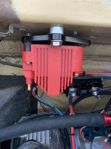

I’ll be installing MSD ignition so I got some wiring to do. Not sure how to wire that in quite yet, gettin rid of the ballast resister and all. I got some reading to do.
My dad and I mounted the MSD ignition box. I have some wiring to do for that and the internally regulated 3 wire alternator. I will be mounting my fuel filter and the carb bypass regulator on the inner fender like so. I am currently using magnets just to hold them as a helping hand. LOL.

This photo shows how I plan to run the fuel lines. I’m gonna hook everything up like how it’s shown, might come out okay. The feed and return lines come up kinda by the alternator and tuck inside the frame, they go around the motor mount.

I did the rest of the fuel lines today. I needed a 90 fitting to come off the bottom of the regulator to go back to the return. Kinda down and dirty I can always change the configuration.
Found a coil mount for the Blaster SS coil.
The fuel lines are done. They are okay…I’m not too happy, my OCD gets the best of me, I don’t like how the feed & return cross over each other but that’s just how the layout worked.
I’m not gonna spend all day tweaking on small ****, it looks good enough I can change it later.
Toss out some ideas if you have some. On to the next items on the list.

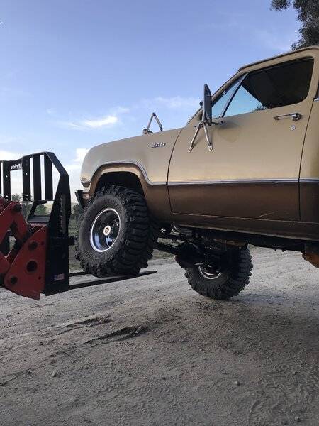

Right now I’m currently running a 33x12.5x15 Nitto Mud Grappler on a 15x10 wheel with 4” of backspace.
U.S. Wheel 70-5080 U.S. Wheel 70 Series White 8-Spoke Wheels | Summit Racing
I HAD a set of 35x16.5x15 super swamper mud boggers, on the same wheels, but they were just too damn wide and rubbed my fenders when I turned. Maybe a 12.5-13.5 wide 35” tire would have fit better!

I really think the problem was those SUPER wide 35’s. I mean 16.5 inches wide that’s pretty damn wide. Lol. Your standard run of the mill 35 incher would fit. I didn’t want 35’s because I have 4.10 gears. I think 33’s and 4.10’s are a good match.
