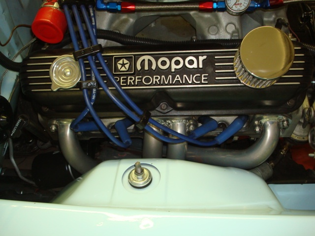

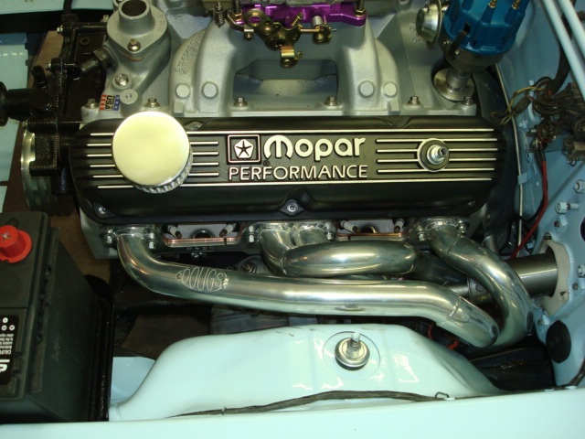

just received my headers for the 273 dartcharger..
They are a work of art.
love them !
What do you guys think of them ?
Do you guys remember which oil filter adapter it requires ?
instructions says straight but sures appears the 90* will work also.

Can't get by with using the short oil filter instead of the long one? I use the short oil filter with my TTI headers with no adapter needed.

I just put them on my 66 Barracuda and I used the 90 degree filter adaptor. You need to remove it to get the header in though.

I just finished installing these on my 63. Not a bad install with the steering column, master cylinder, brake lines, distribution block, z-bar and torsion bars all removed.
The passenger side went in easy, but you need to take them apart. I can't imagine not using the 90 degree adapter. Even with the short filter it would be a PITA changing it.
The driver's side is a little rougher, but not too bad. The only contact point I have is the mini-starter and the lip of the frame rail near the control arm mount. I think the normal starter would fit and some minor hammer work to bend up the frame rail lip fixed that.
Wires on the driver's side is another issue.
They are totally bad *** though and worth the work. Too bad I have to pull it all apart for final paint...
View through the column hole?
I am running the 90 degree oil filter adapter with the Dougs D450 headers on my 64. I found that the torsion bars are about the only thing that MUST come out on both sides. Defiantly a job you would need a helping hand or two with.

A couple more... over time they dull a bit, and mine are scratched up a bit now. I posted the under car pics to show how they DONT hang low.

Great pictures stroker valiant and fzmax !

Those look nice but how do the weld's look close up? A sure sign of quality craftsmanship would be nice,untouched welds that needed no clean up.
For MIG welds, they are ok, could be better. They have no cleanup marks on them, so they were welded once and done. For the amount of money they cost, I would have liked to see them TIG welded. One other thing I did not like about these headers is the bends in them. The drastic bends are mulitiple pieces of mandrel bend, whichs is fine, but there are a couple of compression bends on the primary runners on mine. These headers are 1 5/8 primaries, so that means the are SLIGHTLY smaller on the bends. Maybe I am just too pickey, but overall I am happy with mine just because they fit so perfect.
