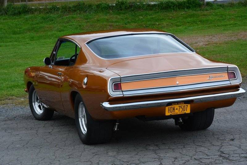

I know is a B body Butt I just luv its rear !
I also did same to my A body , shortened with big brakes and tires !
N50/15 on both !!!
