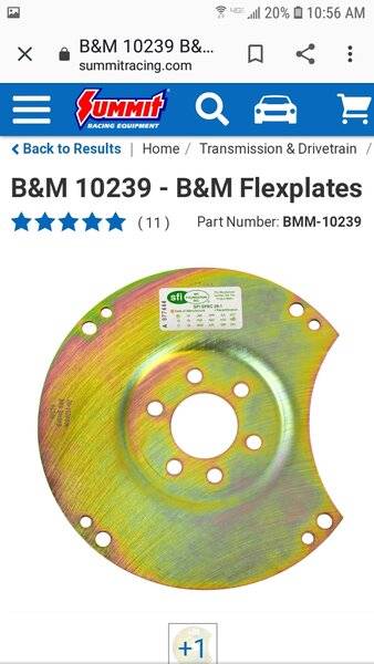

    Hey all, I am going to be redoing my 72 date code LA360 hooked up to my 904. My concern is getting the combo correct as the external balance issue I see a lot of.
    I am looking at buying the following converter from Hughes. The 27-25, per the specs on Jegs, it shows the 360 application for 360s of various years including the Cuda and 75 dart swinger and Duster. The 2500 stall is perfect for my cam shaft.
    Hughes Performance 27-25: Street Master Torque Converter 1968 and Newer Mopar A904 (TF6) 6 & 8 Cylinder | JEGS
    I also ordered already the B&M 10239 flex plate. Which I hope will work with this converter to provide smooth operation
    I just want to confirm this choice or see your choices for this particular engine and trans combo.

      Yes the 10239 Flex Plate is for the 360 external balanced engine, with the 904 and it's neutral balance converter.
      ____________
      The #10236 is the flex plate for 360s and neutral balance 727s.

      I have an external balance 360 thus requiring the B&M plate. I’d have to weight the converter if I don’t run the plate.
      my current converter with the 360 before it broke down has a weight on it but I never liked the idea of it and I think it still had a slight shimmy in the tunnel while maintaining speed. Never had an issue at idle or acceleration or deceleration. Just the maintaining speed part with part throttle.
