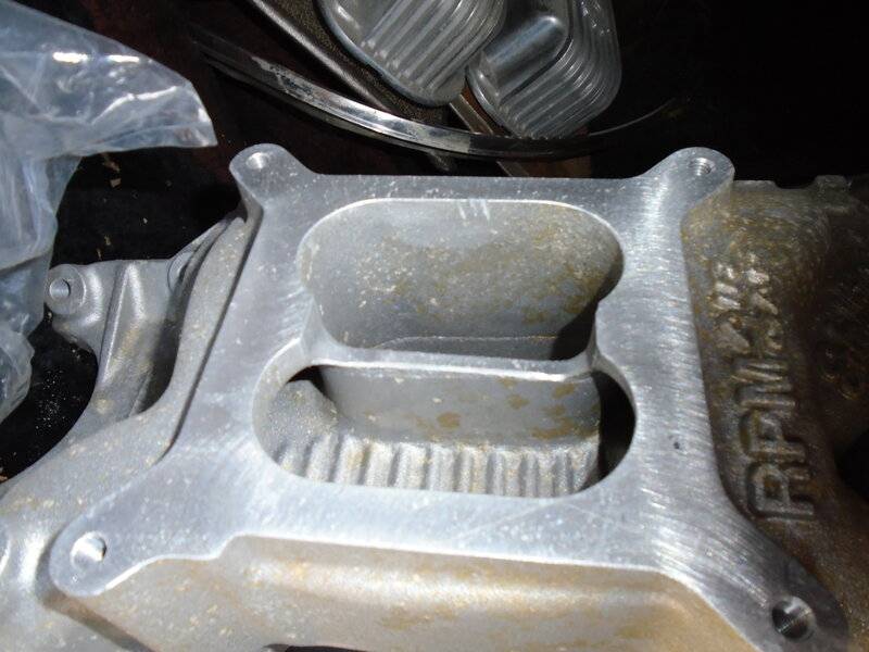

Summit name on it ?
Must be pretty modern offering maybe CHINES'e um ???
Right at the port maybe 1/2” in, the rest looks biggerIf it is the runners are probably smallish
Why did the Summit intake swap cylinder allocations plane to plane?Right at the port maybe 1/2” in, the rest looks bigger
