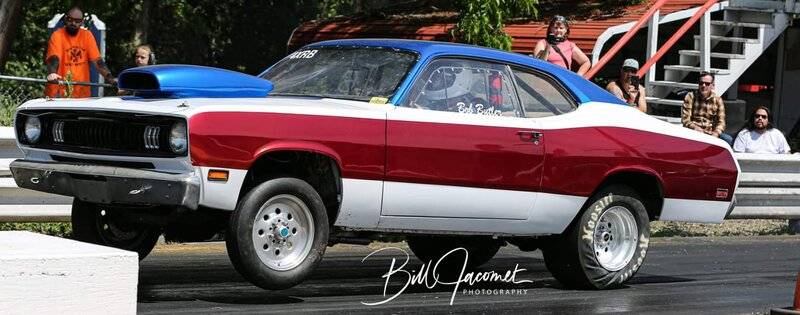

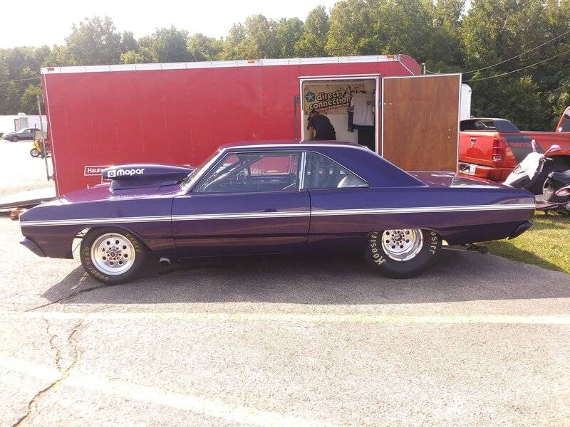

Can you share rear wheel backspace? 15x8's?
I really need to get to that track. Been trying to get out there for years.
Could you please share the rear wheel backspace? Are they 15x8's? I want to get that stance and look for my dart.
Lol, yeah what a junker !
If I wasn't married I'd ask your dart out on a date she's sexy
Hi, been a long time, Yes 15x8's, I had a set of 8" rally wheels on it but they were REALLY heavy, they had 5-1/4" backspace I think, went with the Welds but could only get them in 4.5' BS. so I cut the housing 3/4" each side and lopped the same off the ends of the axles [mosers with about 4" of spline]. Made my own offset spring hangers to move the spring hard against the chassis rail and now had room for 275/50-15 ET streets. Hope this helpsCould you please share the rear wheel backspace? Are they 15x8's? I want to get that stance and look for my dart.

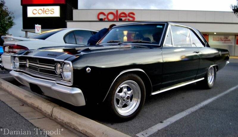

First look: How does it burn out without a driver?
The bars and the hood are glass, still got the mint steel hood that the mold came from.First look: How does it burn out without a driver?

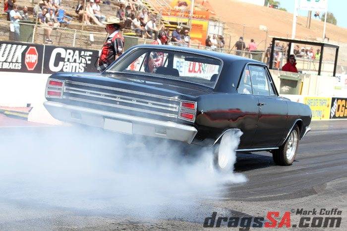

Second look: Australia. Got it.
Great looking car. How much fiberglass is on it?
