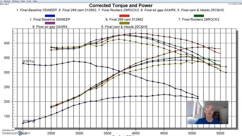

Here's a video on a mild low cr 360 from 225 hp 2bbl to 387 hp 4bbl cam etc.. and few steps in between. Worth a watch.

Here's the dyno result's to that video in post 12, Where is the supposed loss of torque over stock 2bbl low cr 360 ? (1. Final Baseline in Blue is like 340 lbs-ft peak) every single mod (including both cams xe256h and xe268h) is making about 50 lbs-ft over stock at 2500 rpms and almost making a 100 lbs-ft at peaks, look at all that extra power from 2500, possibly 2000 rpms and up to 5500 + rpm.
If peak torque hits at 4000, that would be about 44mph, so, you'll have a bit of wait until the engine gets up on the cam. In other words;
Notice that xe268h cam makes peak torque at 4000 rpm but also notice it makes way more torque practically everywhere by a huge margin than the stock 360?
Just cause it peaks at 4000 rpms doesn't mean it don't make useful torque at lower rpms also.
