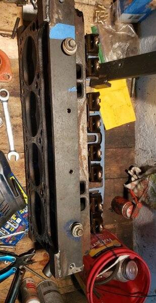

Yeah it would have been nice not to spend $80. I'll have to re read the thread to see exactly how to use this gig and it being off 1/8 inch
I references a hole being off in post # 125. Not an 1/8, maybe 1/16 inch.
Also I drilled all of my holes dry with no cutting oil of any kind.
One thing you want to be careful of is when you get to the bottom of your hole in that your about to push through don't strong arm it you can pop cast iron off the head.
I drilled all of my bolt holes completely through. When the manifold is bolted on the bolts will plug the oil from seeping through there.
Am I using this right? I know I need to use one to hold in place while I drill middle holes. Then use other to dill outter holes. Also one is off but a little to so I'm told.
Just finished up. Works great and bolted up perfect. All said in done I had to pay $80US to ship and $30US border fees but it was worth it. Going to pass along the template to a buddy of mine that is having trouble with his fuel injected magnum so he is converting it to carb. I got a spare 2 barrel intake and carb I'm gonna give him. He should be joining this forum soon and he will pass along the templates to whomever wants them next.
