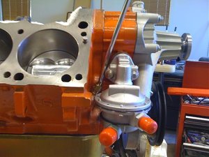

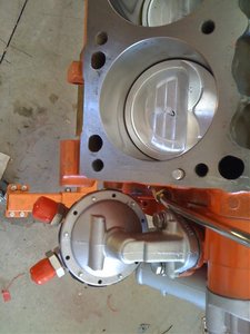

This pump is in no way small like the stock bodied pump. It barely fits and I had to Grind my block away about 3/8's of an inch for it to clear. For what I am doing it should be fine. Carter says it will feed a 800 hp engine, I dont know about that though........should be good enough for what I am doing.

Here is the picture after I ground down the nipple you see on the block to clear the pump. I took it down around 3/8's of an inch.

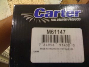

just curious,,whats the pressure on this pump ??? you say it flows 172 GPH ?? got a part number ??? ide like to look it up,,,looks lime my carter,,,but didnt have to grind any thing,,,my pump claims 120 GPH, thanks in advance,
Part Box picture is in post 40...............Pressure is 7 to 8.5 lbs.
