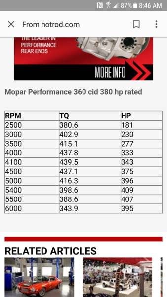

...superior to Mopar's 380 hp 360 crate engine with a smaller cam?
Not really the crate does 410 hp too just takes 300 rpm higher with more cam and less head flow, 67autocross is the better way to go with airflow more streetable.

You got a better under the curve, the only thing impressive about the crate is its basically a cam in a stock engine,I'm changing the cam and intake on my crate engine to a china air gap and comp roller very similar to your specs, looking for more of a driver, later way down the road, I want to port the heads or go with trick flows.
