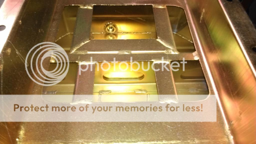

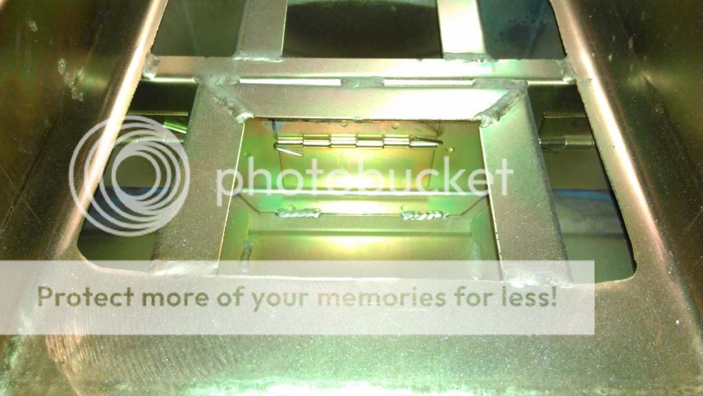

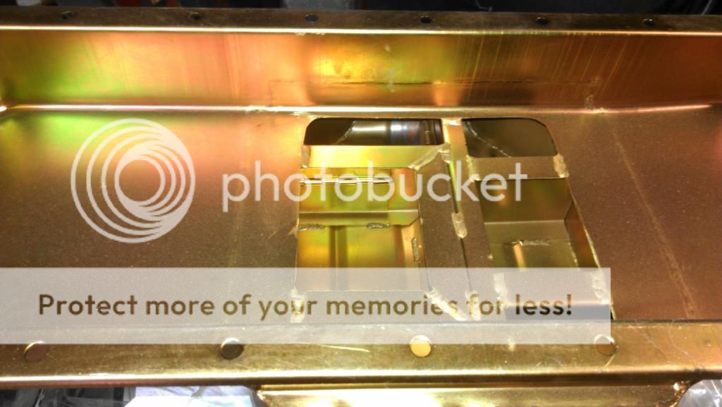

I was interested to see what it has inside , are there trap doors or just fixed baffles , what p/n pick-up are you using .
Trap doors. Its pretty sweet and IMO pretty much explains the price. I am gonna use the same pickup the 31000 uses.

Does this help .
