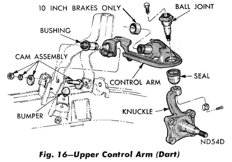

Beats me. I doubt any of the cars I’ve worked on were last touched at the factory and the ‘71 FSM doesn’t specify a direction and the illustrations in the FSM only show one bolt, and has them going opposite directions in the Dart and Challenger illustrations.

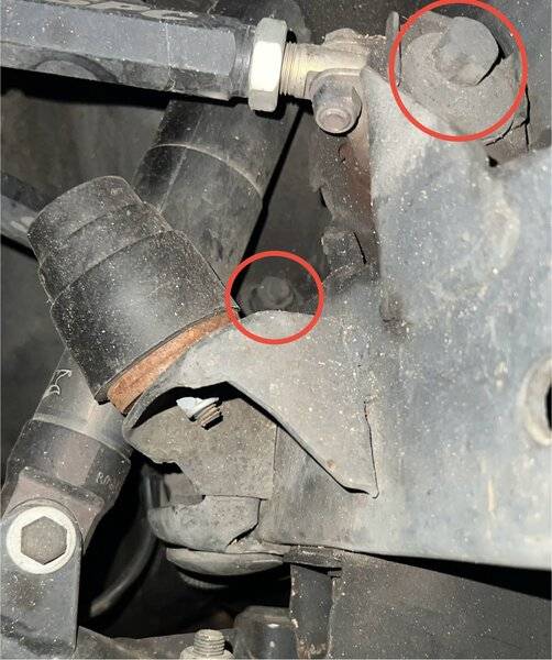

I just checked my Duster, my camber bolts run outside-in. Pretty sure I did that so it would be easier to adjust the bolts during an alignment.
