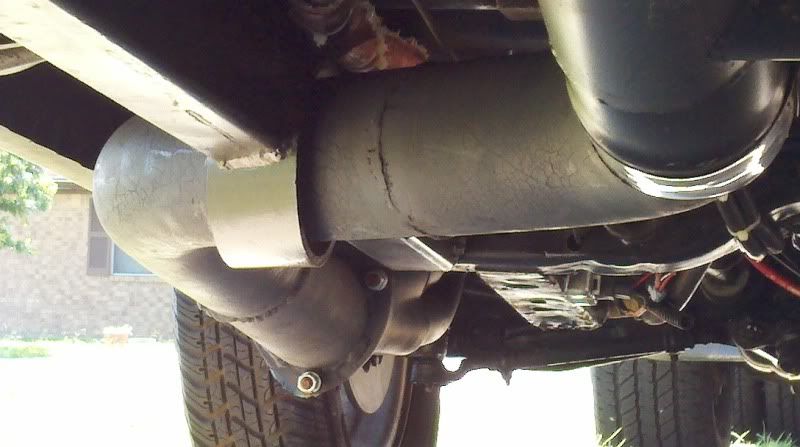

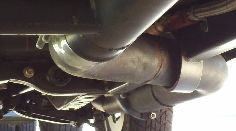

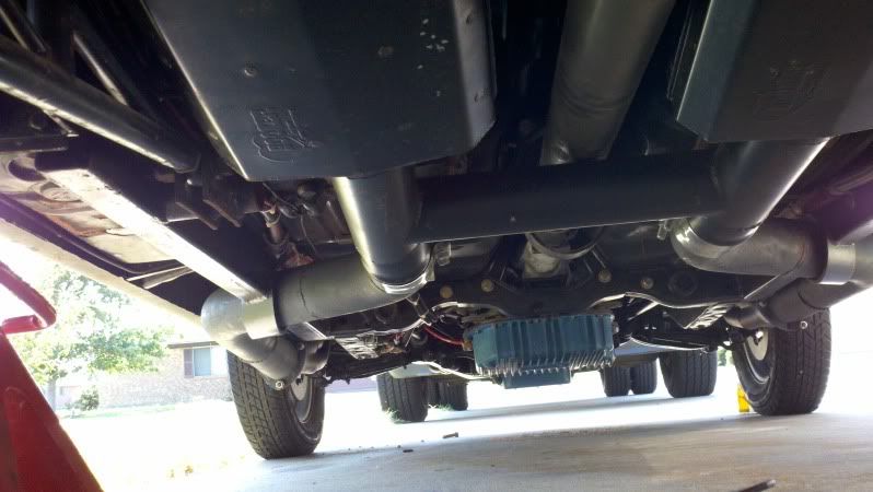

i can think of at least 2 cars that we have done... the purple dart and the lambo orange dart... my computer is dead so i have all my pics stored or i could post some for you...
Thanks, mopwr2004a! That's what I'm trying to get. I didn't see why I copuldn't run the pipes under the gastank, but this shows it can be done!
problem is going to be getting around the right front corner of the tank. got pictures on my dead lap top, i will go see if i can't kick start it one more time.....
these pictures are of 3" pipes. don't think there will be any way to get a bigger pipe in there......going under the tank is going to have them hanging pretty low and require a 90 degree bend i would think....
as you can see I have a fuel cell in the trunk. I think if you really wanted to do it. take a factory tank and narrow it on both sides by a few inches. lots of welding but it is possible, or order a custom built replacement tank. It just depends on how bad and how much wrk you are willing to do to make it happen. it's metal so it can be cut and welded back together.
in the link i provided someone did talk about/post pictures of trimming the tank down.....only was needed on the right side....

yea we go under the tank... and its not any more of a bend than going over the axle...
