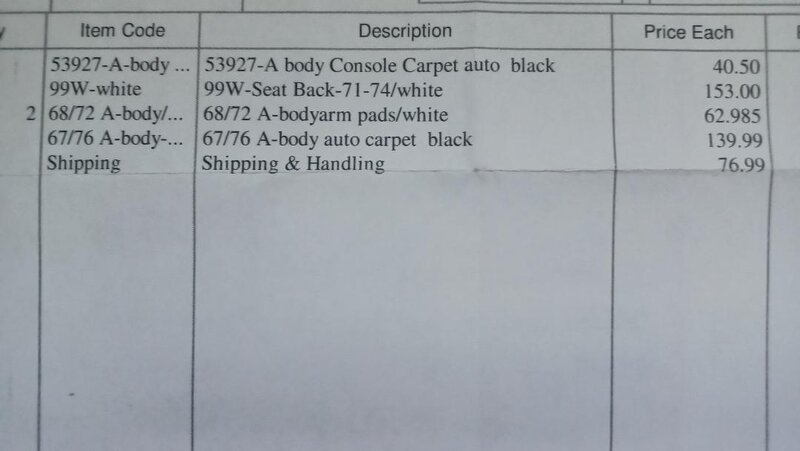

One thing to know. I had to buy new seat backs because I went back to my original color which is white. I don't know if there are different manufacturers but the ones I bought I would not buy again if I had a choice. They look really good BUT they are not the same type of plastic as the originals and that seems inexcusable. The originals are thicker and a forgiving softer plastic where these are very stiff and somewhat brittle. the bends at the bottom where they cover the pivot bolts are a little off and when I flexed them a slight bit I put a small crack in the bottom which isn't really noticeable but there none the less. the material at that point was extremely thin. I really couldn't complain to them because I had this stuff for at least a couple of years before I got to it. Be sure to verify that in your search.

Not exactly positive but I got them through Dante's. Here is a link to what they offer now claiming to be a Must for a top restoration. attaching a pic of the receipt also because the part # on it is 99W which is different. I bought them 7 years ago, as you can see by the prices! Time flies, LOL, so maybe they've changed. I can't believe they wouldn't have gotten a lot of complaints.
