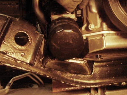

Dont get me started on Magazine articles - I have a lot to say about the Milodon oil filter adapter that was "alleged" to work with the 6.1:protest:
More on that later...but lets just say I wasted $40 on a part that was NEVER going to work.....
JD - I'll detail the issue with the milodon plate in a separate thread.

Hey Joe not to hijack this thread but I also bought the oil filter adapter and it WASN'T just notching the k-frame or I would have done it--It does NOT fit with the TTi mounts,If anyone needs one I got one,Just let me know--Steve
Hmmm, I hope you're wrong. I don't like the idea of oil lines, I'd much prefer to use the adapter. In the picture above it looks like the adapter is just touching the motor mount. It appears that you could clearance the mount and make it fit.
Also, I wonder if there is more clearance with the spool type mounts. Although my car is a '67 Dart, since it is a slant six car and I have to change the K-Member anyway, I've bought a 73-76 spool mount K-Member. So we'll see, if you have tried to make it fit with a spool mounts and found it impossible, let me know, so I don't waste my time.
Since the K-member is not in the car I plan to mock everything up on the K-member prior to install, at that point I'll have a definitive answer.

Hey joe same here
For my 1970 duster, I bought the 45 degree adapter. I have a 5.7, sandwich mounts and the tti mounts. I went to go mock it up and the adapter on the passenger side is hitting the oil filter adapter. As far as clearance between there and the k-member. I had plenty. I would have had to cut out half the adapter and notch the sandwich mount just to fit. So I'm going with the oil filter relocation route. I have heard different stories for the same models. Good luck.
Something Ive just discpvered from another tti user is that when using biscuit mounts, the tti adapters raise the height of the motor significantly - creating pinion angle issues.
I may well end up using one of our local 6 cylinder K frames because they have lower saddles.

TTI oil block off plate - PN 0200-FBP
Because the factory A Body "K" frame fouls on the factory 3G Hemi oil filter , you have to consider which way you want to tackle the problem.
You can use a Dodge Dakota truck angled filter adapter - but that requires running a very short filter - and still requires some notching of both the adapter and / or the K frame.
As I run a remote oil filter system anyway..I've chosen to use the TTI filter boss block off plate.
The 3G Hemi has remote auxilliory oiling ports directly above the filter boss....making it easy to tap remote oil hoses directly into the block.
This pic shows the oil filter boss..and the original threaded oil filter screw fitting. You'll need a 12mm allen key to remove this.
This pic shows the TTI block off plate partially attached - its a perfect fit and uses O rings to seal to the boss.
The TTI engine mount adapter requires a small amount of trimming to clear the plate - not sure how TTI could have missed this pretty basic issue.....:(
So there you have it!
Two option to run the oil filter system and either will work with very little drama
