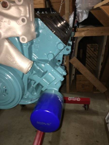

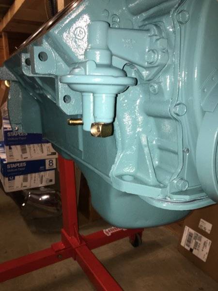

Lets see a whole shot of the short block. Heck yeah man. Progress.
Oh, I should mention, the 225 and 904 need to come out so I can clean up the engine bay over the winter. With all the Pittsburghers out there: I got a nice running 225/904 real cheap.

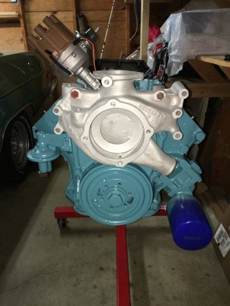

Rob, ask and you shall receive. I feel like a proud Poppa!

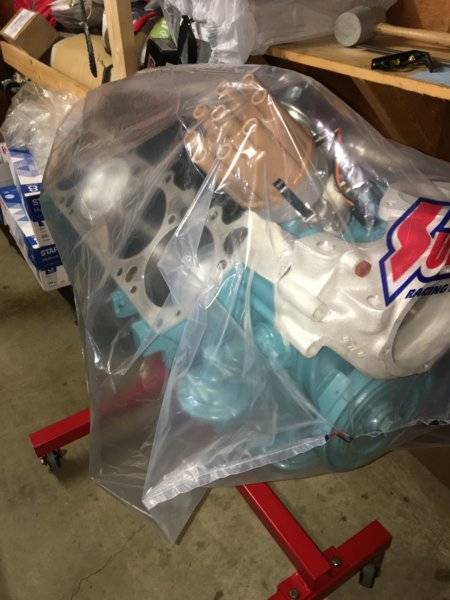

And all bagged up...
Very nice, gonna be a good engine when you're done. Did a few myself.
In the first pic of the short block, your teasing us with a shot of the quarter and rear wheel & tire. I’d love to see some of the whole car! The short block looks like it’s coming along nicely. Is the water pump housing aluminum or cast that’s just painted silver?
That housing is an 1965 Hemi SS Aluminum piece I got from ebay for $169. I couldn't pass it up. It's media blasted and bare now. I'm painting it along with an aluminum intake (Edelbrock Performer 383) when I buy one, LOL.
Street Dominator would be better. Look better too. lol
The distributor is new, but superior to the new "Mopar Performance" aka Proform distributor. This has the Chrysler internals as original. I scored this one from Ehrenberg on eBay.
I didn’t realize Proform was making them for Mopar Performance. You wouldn’t happen to have his eBay name would you? I’m going to need one for my 440
They are not that I am aware of. Mallory is.
The Ebay seller is no other than Rick Ehrenberg, former long time tech editor of Mopar Action. :)

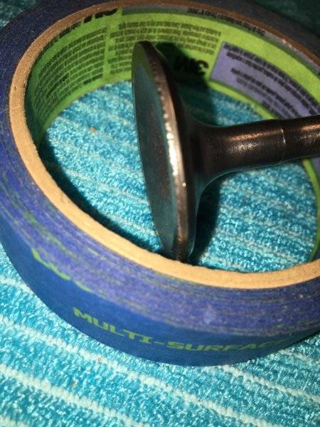

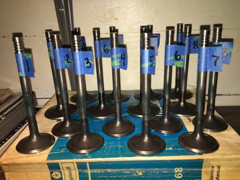

I've moved on to the cylinder heads. Using valve spring compressor tool OTC 4572, I removed the springs and valves. Nice tool! $45 on Amazon. Here's the clean valves, and a pic of one of the exhaust valves I'll be replacing. I'm not sure how to read this damage, but it appears to have "flea bites" chips around the outer edges, but not on the 45 degree surface making contact with the seat. I read this can be the start of what will eventually be a burnt valve.
And the damaged valve:
Luckily, I scored two NOS exhaust valves on ebay, they're on the way.

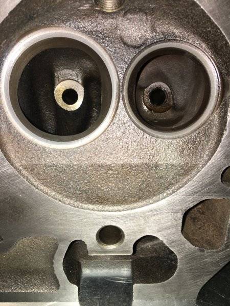

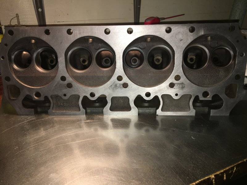

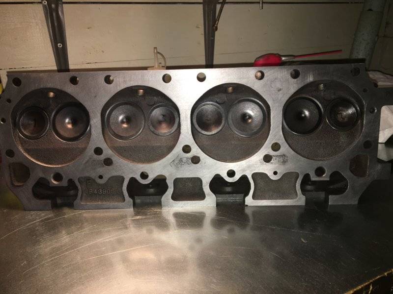

I broke down and brought the heads to a local machine shop to hot tank and "wet mag" the heads ($75). No cracks and now they're cleaner than I would have got them by hand. I'm now lapping valves for the first time.
Hi Rob - the guides look good! Also, the valves seemed fairly easy to lap. I used the permatex valve compound and Prussian Blue. I think I'm reading it right.

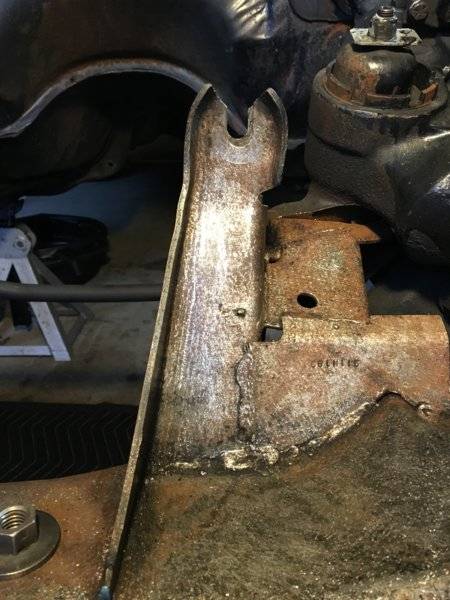

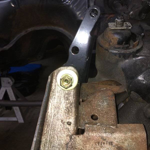

Well, The social distancing has brought me closer to the Scamp! My wife took this "action shot" lol. I've modified the driver's side perch as outlined in the Schumacher kit.
More to come...
