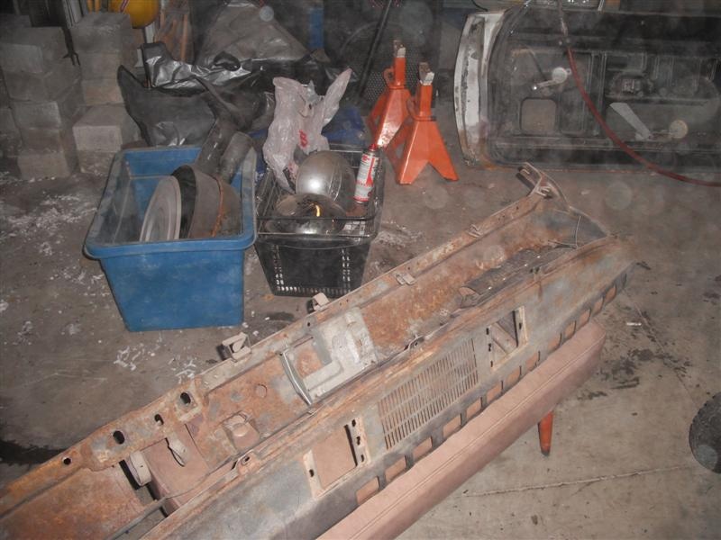

Well I figured I had given Rani and Cosgig enough of a head start, seeing as how my bezel and dash is already outta the cuda. Here are some "G" rated pics. Inst bezel is complete, no cracks(yet!!), but it is faded pretty good. My plan for now is to go with the wood grain decal kit, but this one has the "black upper" and its textured...dunno if that will make a difference or not. Either way it needs a facelift so I will give it a shot. I plan on lightly LIGHTLY sandblasting the inst bezel(real low psi to start and test). The dash is in pretty good shape too but needs a "boob job"(I already used "facelift") Kinda fits as its a vert/topless right?? Aaaaanyway, I dont think the frickin dash frame will fit in my cabinet. Soooo big messes a coming! I will start out with the bezel 1st and then move onto the frame. Car is nowhere near being done, but Im looking forward to having fun and maybe knocking something off the "to-do list" As I move fwd in this chapter we will see about "upgrades". Im thinking LED's for the lights, dad and I sent in our factory tachs to get the upgraded boards:cheers: in them. So that will be going in...I shoulda sent my 150 speedo in as well:banghead: but was more concerned with dads stuff getting done. As for supplies, I am open to suggestions on the bezel, but for the dash I am using etch primer, then Marhyde "satin black" interior trip paint. I heard its good stuff! I am open to any suggestions for materials? Hey I might be "bringin up the rear here", but Geoff ya gotta admit, the view is better, as long as yer arse doesnt block my view of the Duchess of Darts!!
Materials(for now)
Decal kit for inst bezel
Etch primer(spray bomb)
Marhyde Trim Paint Satin Black
LED's

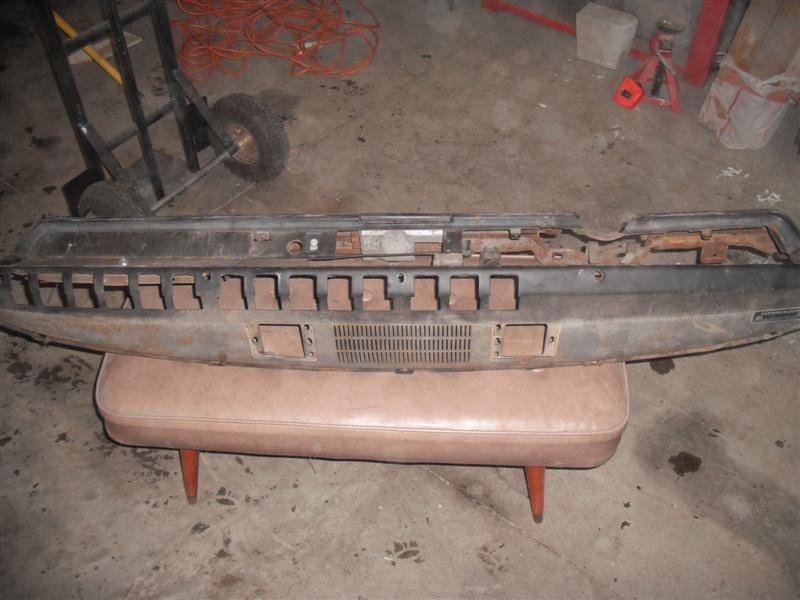

Oiy...OMG, Ladies and Germs,...Looks like 4spdragtop is still on the track,...Lets see what the weekend brings....

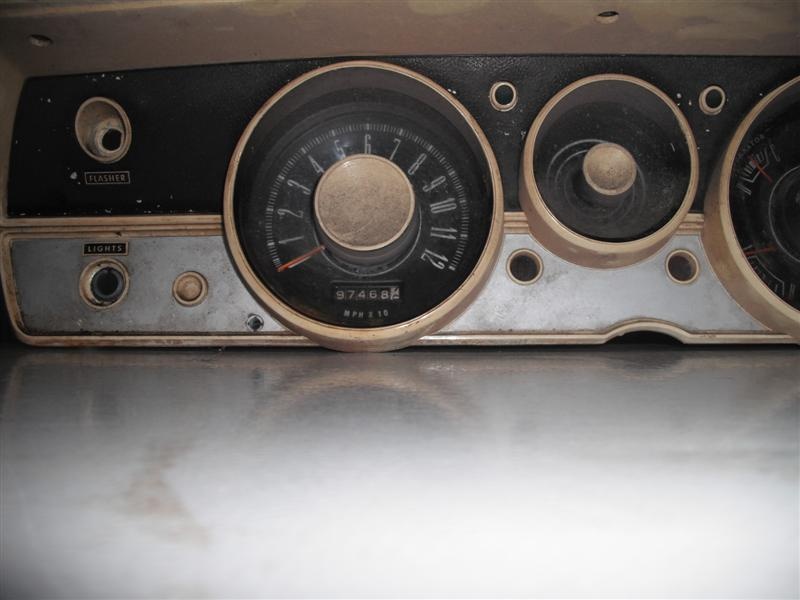

Here's a few pics of my progress over the last couple days. The cluster is out and stripped down, the dash frame is on it's way to PSC, and a little side project has revealed itself also. When we got the car, the owner had taken out the heater box and just left the fan to block the opening off. Something about not needing a heater in a convertible I think!! Anyway, I don't roll like that and will be redoing a box and fixing that problem as well. That should keep me occupied while the dash frame is being worked on and the bezels are being redone!!
So, thats it for this segment of "The Gauntlet", until next time, keep 'em between the ditches!! cosgig...OUT!!

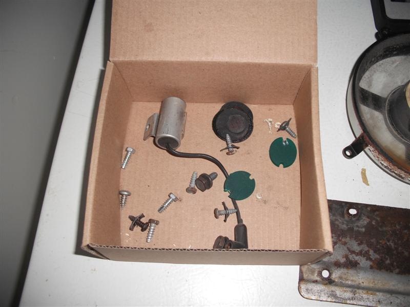

Well, got the bezel completely apart. I used the "Solder It" Solder Pro 70k to melt the plastic that held the dash lenses in. Worked pretty slick!!Used it for the turn signals indicator lenses too. Lenses are pretty dirty, Ima gunna clean them and see if they need a polish or not, either way the plastic centers will get a cleaning and a fresh coat of paint on them. For some reason me thinks Ima gunna need my glasses or big-assed magnifying glass for a lot of this tedious stuff! Im hoping tomorrow to get the top steel plate blasted, as well as the bezel. Looks like I may need to book a full body wax job for the awards ceremony! Gotta look my best ya know!!:hello2:
