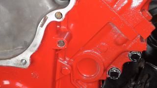

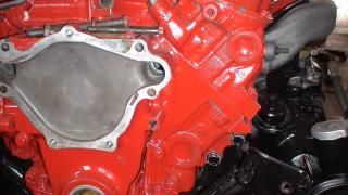

Had the water pump on and then saw this empty bolt hole in the timing cover, couldn't get a bolt in there due to the water pump outlet, pulled water pump, only to find that this bolt hole doesn't seem to have a corresponding hoel in the block. Is there something that supposed to go here? Is it ok to leave this hole open? The hole is just below the water pump on the drivers side, I checked three other timing covers and they don't have a hole there, they are all 73 up(or whatever year they changed to the aluminum pump. Here are a couple pics.
Thanks
Aaron
it appears to be letting oil out, so i would say its no good. i cant say i have ever seen one with that hole
Oops sorry that first pick is a piece of wire I was pointing at the hole with. Not sure if I should put the water pump back on. Had to go to 2 auto parts to get a new gasket. The first one said "we can order it, it would be here tomorrow".

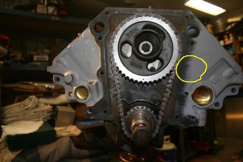

I seem to remember that same hole when assembling my engine, a 340 that I set all up with pulleys, water pump/front cover and bracketry from a 273. I got the feeling it was probably to correspond to a hole in an early 273, but then deleted on the later engines.
That is totally normal. No hole in the block to put a bolt into. Not really sure why the boss is there in the first place. No worries.
