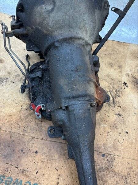

Wanted to start a thread on my 1968 dart GT we will call Nevada Blue. Future plans 340 , 4 speed. Needs lot of TLC but is all there found remnants of build sheet to me thats a good sign. Been collecting many parts dash pad, steering wheel, 4 speed pedals and console shifter, disk brakes will up grade all to big bolt pattern. I dont know everything but use this forum quite extensively to figure it out. I read many threads here from other members so just wanted to start my own. First off is to get everything running before the 4 speed and 340 go in. So first i have been disassembling motor and some interior to everything cleaned up.

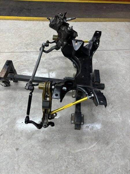

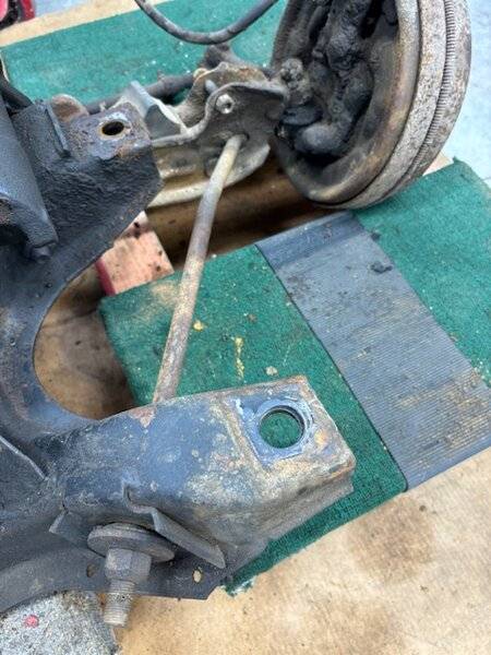

Today will be cleaning up the 904 and front k member , will be up grading the k member with 108 torsion bars and a complete rebuild of front end off set upper bushings big ball joint uppers 68 lower control arms with sway bar tab , hellwig sway bar, 4 piston disk brake set up.

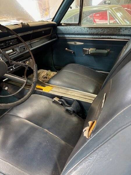

the trim correct most people remove them for now it will stay. The 340 I got off another member pretty cheap with 727. The seats are in great shape and the body I’ll leave as is but make drive train will all be redone. Want it to have that ratty look for now and not worry about door dings and drive the hell out of it. But handle well.
Was going to power wash the trans but power pump went out basically the power washer is new used it twice. So that turned into another project had to buy new pump, took it all apart found nothing wrong even took it to a small engine repair shop he would even touch it said that husqvarna is Costco Chinese crap. So cleaned most by hand . Got the k member apart it’s in the hot tank for now. Bottom of it is sure smashed in not sure how I want to fix it.

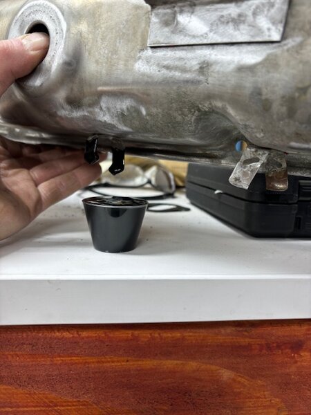

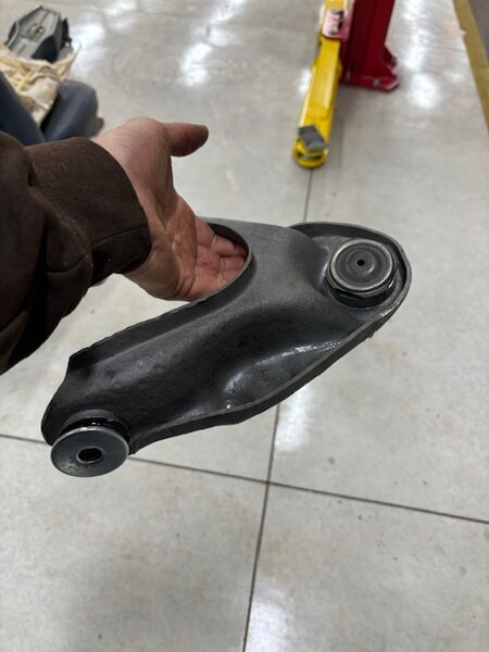

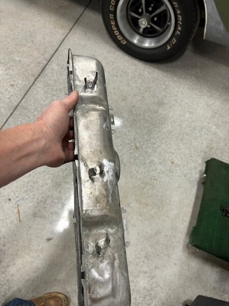

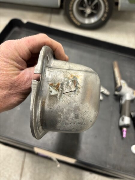

Not to much done as I only get into shop 1 day a week. This past weekend I was able to hot tank the uppers control arm soak them in T-9 install moog offset bushings and ball joints. Passenger side valve cover needed to replace 2 wire clamps. So I ordered those from mega parts sanded the old ones off then spot welded the new ones on. Then moved on and dipped the old ones in plasti dip. Difference is the mega ones were gloss and the plastic ones came out flat but whatever.
