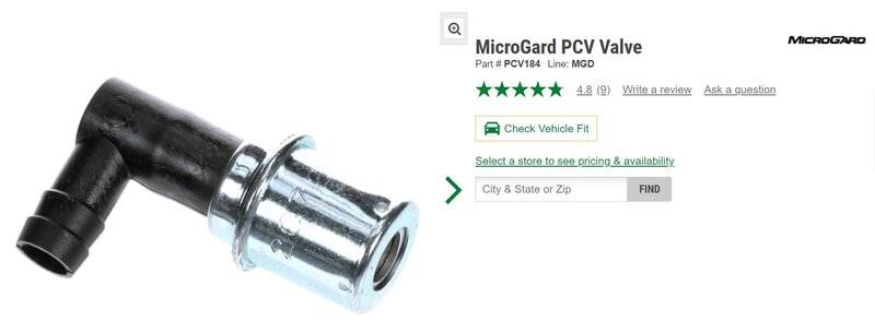

This is what my engine builder put in my rebuilt 318 last winter:
It came from O'Reilly's.
