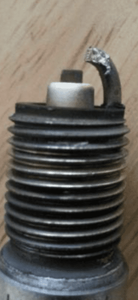

When the timing is close to the ragged edge, the first thing to show signs of it, is the ground strap. It will melt back the end of the tip.
Not a good pic but you get the idea. This is case of too much timing and heat in the ground strap.

When the timing is close to the ragged edge, the first thing to show signs of it, is the electrode. It will melt back the end of the tip.
