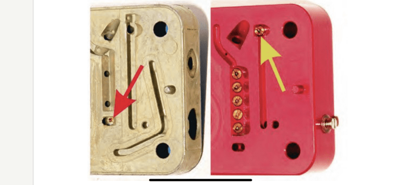

That includes;
1: air bleeds
Low speed and high speed
2: pvcr power valve channel restriction (holes behind power valve)
3: emulsion holes in the metering blocks. (How many and size of each)
4:idle feed restriction (high or low and size) see pic below.
In that pic you can also see the emulsion holes. 2 on the left block and 5 on the right block.
That includes;
1: air bleeds
I think Inertia has a pin set. If not I'll pick up a set so we can measure all the holes in the carb. And I'll probably end up needing a thousandths inch drill bit set. It's interesting for me to be getting this deep into carburetor setup as I haven't gone this deep into their actual function yet.
You may not have to get in too deep. But you gotta start by knowing what you have. And if you want get the carb dialed in right, and I mean really right, you have to do all this stuff. Also before it’s apart, take it out for a cruise, light throttle medium load, not on the mains yet and take note of your cruise vacuum.
