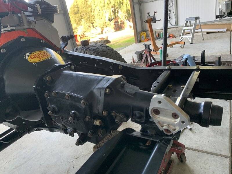

How do you like that 4050? I think they now offer a two wheel drive unit which would work perfectly in front of my divorced transfer case. I don’t know what bellhousing they use for the TR4050 and a small block??Nice truck. A 4x4 727 is basically a direct swap. Same length and same crossmember mounts. The auto brake pedal is a direct swap for the manual brake pedal and clutch pedal, I did the opposite to my RamCharger… 727 to np435, and now TR4050!
The 4050 is great. My truck is still running 3.23 gears so it’s not perfect for those. But once I swap over to one ton axles I’ll probably go to a 4.11 or 4.56 which would make the transmission perfect IMO. The 4050 has the same pattern as an NV4500 so you could probably find a factory bell out there somewhere. Because I have a big block I had to get the Lakewood scatter shield bell that’s worth its weight in gold, and I had to swap the input shaft on the transmission for the longer unit.How do you like that 4050? I think they now offer a two wheel drive unit which would work perfectly in front of my divorced transfer case. I don’t know what bellhousing they use for the TR4050 and a small block??
