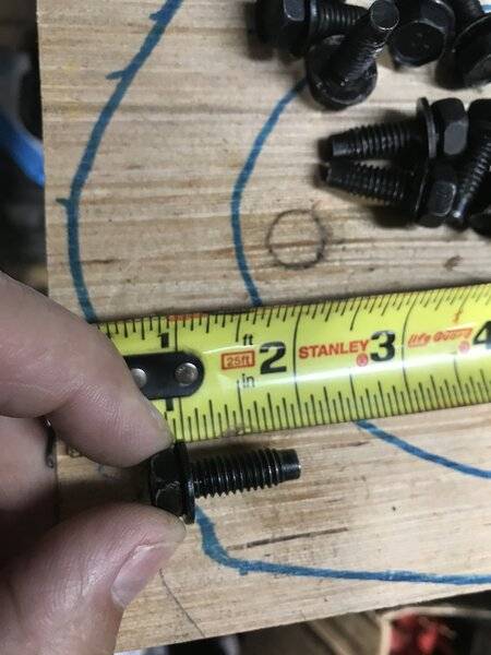

UPDATE…. Problem Solved!!!!
The Bolts I was using were for the Magnum Motors… made sense to me to use what it came with it!!!
Wrong!!!! The OEM Magnum Bolts are 7/8 in length and the OEM LA Bolts are 3/4!!
So the were tightening just enough but not quite sealing the pan along the sides and would leak only once it got up to around 180 degrees.
On the Front and Rear where they go all the way through… no leaks!!!
So, installed the correct length and now no issues!!!
