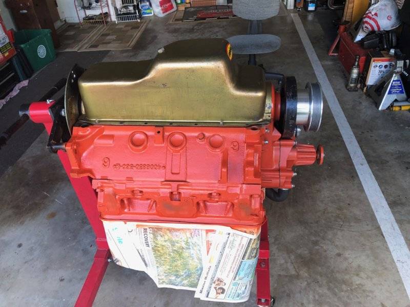

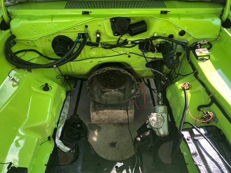

Some first time engine pull pictures"under my ownership of this car"

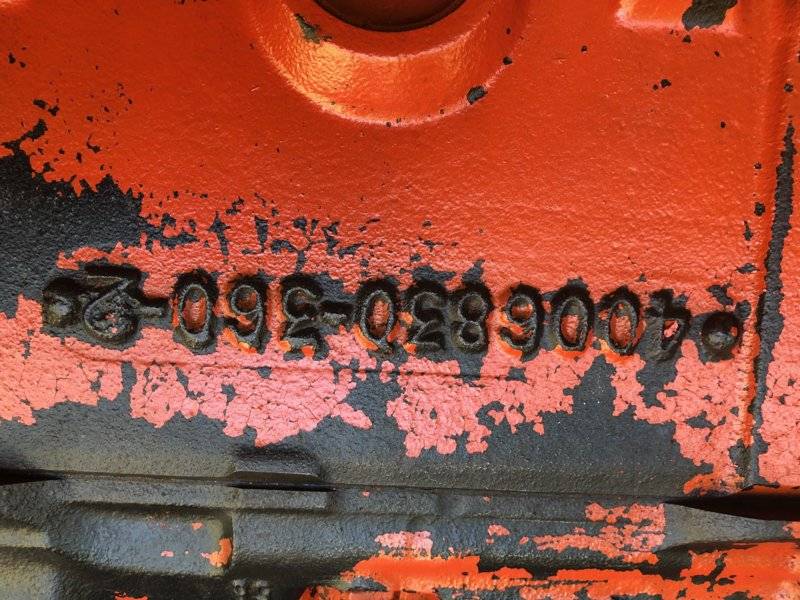

I'm puzzled as to why this engine was once painted black? Was that a Mopar color at one time?
That's just well-preserved cast iron. Rusty, covered with a little oil that has probably been there almost forever. Probably why the paint didn't stay on it.
A lot of the '80s-'90s engines were painted black. But I don't think that's what you have unless someone swapped heads at some point (would not make much sense though).
