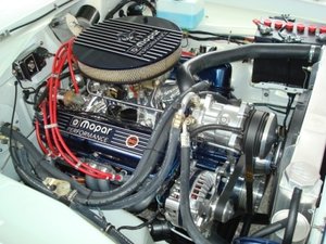

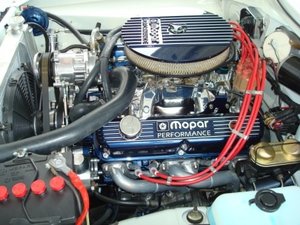

I have a .040 340, iron "J" heads, that has been the engine from HELL. It came out of a 71 DEMON and I think it is POSSESED.
Be Cool radiator, AC water pump, TTI headers, Air Gap intake, electric fan and the March Pulleys
It was built about 8 years ago, installed in 2004 and car on the street in 2005. In 2005 the engine was removed and gone thru again due to bent pushrods and valves. At this time we installed March Serpentine drive belt aluminum pulleys. Heating issues came up and I contacted March about it wanting to know if it was an underdrive system.

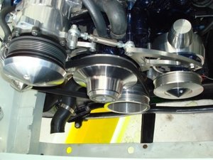

Over the winter I questioned many friends running small blocks and what they have done to keep them cool. Measuring pulleys I find the water pump pulley to be 7" and crank 5 7/8". I contact March again to see if they have different pulleys for a small block and one guy (on phone) said I needed to install restrictor to slow the flow. The one that emailed me after about 2 weeks that I have an underdrive (why in the hell didn't they tell me this in 2006?) and they now have a 5 3/4" water pump pulley. So it is on it's way.

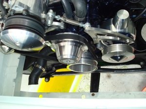

The new pulley came today and it looks like a mini pulley compared to the one on it now, it should speed it up.

I would say it helped. Before cruising it would run about 190 and yesterday it was on 170, stop at light it went up a little but still under 180. Once home I let it sit idling and yes it heated up to over 200 but took 10 - 15 minutes to do so.

larger pulley is what I removed
with underdrive pulley
with new smaller pulley
Looking at the pictures I need to clean the engine
