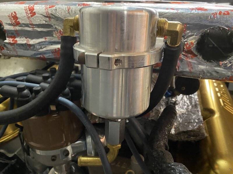

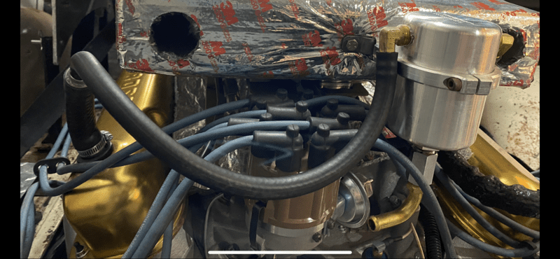

I run a fixed orifice (small ID hose inserted into a gutted PCV body) along with a Moroso oil separator for my system. Even with well designed valve cover baffles I still get some oil drawn through but at least the engine ain’t sucking most of it in, just drawing in the blow by gases like the PCV setup is supposed to.:thumbsup:

So the copper looking 90* at the bottom of that spun aluminum canister gets connected to manifold pressure? or the back of the carb....same same?

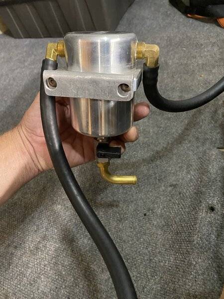

That tube you see is the drain (there’s a lever on the other side of the big hex that tube screws into that rotates to drain) for collected oil. On the top right side of the canister (barely visible in that posts picture) is the stub for the hose that goes to the carb. Better pics:

I run an oil separator as well with the adjustable PCV.
I fabbed my own baffles and TiG'd them in to my covers (they're 440source fabbed covers that had none). When the engine's running you can pop the breather or PCV off, feel the topside of the baffle and there's little to no oil on the surface, and the bottom of the PCV is dry for the most part...but there's so much mist flying around at higher RPM that it still sucks oil.

I get about half a shot glass worth of oil out of the separator every few hundred miles. That's oil that would have gone right into the intake tract:eek:

There is a low dollar option for us but either the adjustable or non adjustable setups should have an oil catch between the pcv and the carb
Why? you ask...the oil vapor dilutes the mixture and causes detonation that cannot be heard at high rpm but shows on the plugs if one is paying attention. The oil catch can be something fancy from the aftermarket [ i like the ford mustang based products] but for the tight wallet - use a see thru fuel filter. Actually one car I work on has an adjustable pcv and the fuel filter as the owner's priorities are a little skewed at times. Like p-poor seat belts in a fast car and a broken front seat spring or 2. If you have power brakes there is gm based filter and check valve you should have installed between the engine and the booster. As for the seat belts; 3 inch seat belts with the conventional release like 1970 are less than $50.00 ea - not expensive but smart - see the interweb.
