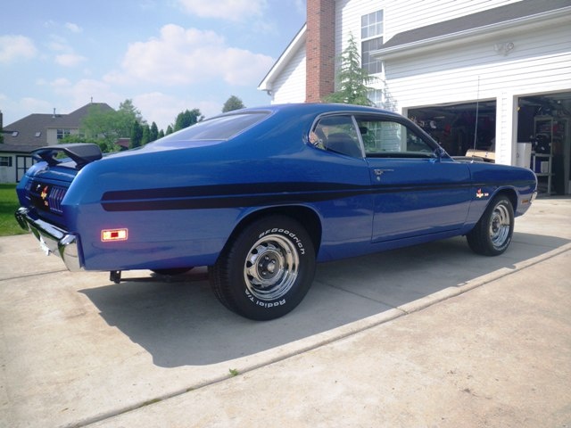

Front: Polished Ansen Sprint 14x6 BFG 225/60-14
Rear: Polished Ansen Sprint 14x7 BFG 245/60-14
